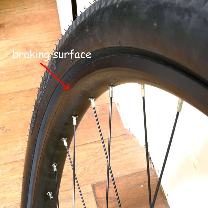

Interesting! I wondered if something like that was available. The only concern is if the rim would work well for that. It doesn’t appear to have a braking surface. When I get a chance, I’ll take an up-close photo and maybe someone can offer an opinion. Thanks!

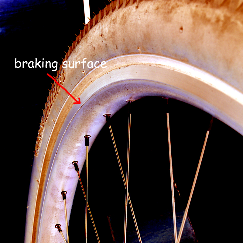

I’m fairly certain that the rim has a brake track, it’s just powder coated. Disc rims without a brake surface are made with very narrow edges, or sides that are angled so that a brake pad wouldn’t engage effectively. For years rims were made for brakes without having a machined sidewall. The Stealth 2 rim looks like it has a decent braking surface. If it’s painted that will wear off in time, although it makes it pretty noisy.
No, you’re totally right. The Stealth 2 does have a braking surface. It is just powder coated with the same black paint as the rest of the rim and even blends in with the tire. Since I didn’t think I’d be able to use rim brakes, I guess I didn’t look very hard. Even overexposed, the color picture I took doesn’t show the surface very well, but it’s really obvious from the negative image (both below).
If the paint did become a problem, I might be able to carefully remove it.

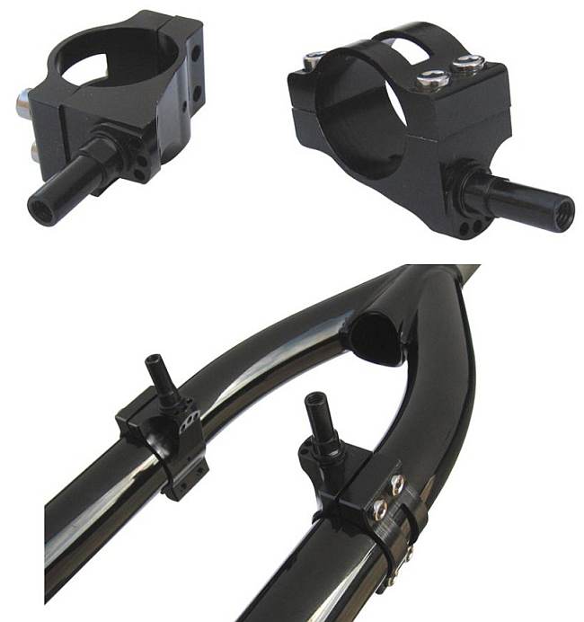

This also looks like a relatively elegant solution for adding v-brakes (see image below). So far, I haven’t really been able to find a site to buy these, at least not in the US or a site in English.
Wow, very cool! Where did those come from?
I can’t find the Czech website I originally found it on, but I think I found the exact same thing on a UK site here -> http://www.tredz.co.uk/.Identiti-Rebate-Rim-Brake-Adaptor_43426.htm and the manufacture’s website here -> http://www.identitibikes.com/FKITRBA/Rebate-V-adaptors
These particular clamp-on brake bosses seem to be proprietary for a certain fork.
That could be a good solution for those who want to build a G32 with rim brakes from a 36er frame.
The big question is: Does the Rim brake adapter fit to the diameter of the Nightfox fork legs? Otherwise you won´t get them fixed.

I ran across those Identity brake studs when I was looking for “Moots Mounts” for my uni. I ended up finding a BMX company that was willing to mill some to fit my Nimbus frame, but the cost was going to be something like $60-70, so I went with the strap on adapter.
I still think that if you found some “Moots Mounts” for a fork you could make them work. Maybe if you could reverse engineer the concept…
Get your point. Then I would contact a bike shop which offers those retrofit Canti mounts and let them measure the diameter. Then you know if it will work or not.
Very cool! I like the design of these. All kinds of ways to adjust them!
Yeah, they were a cool idea. It was from the early days of mountain biking when they hadn’t rested on a standard wheel size. So, Moots decided to make their MTB to fit 26", 650b, and 700c wheels. The brake studs could be moved to fit whatever wheel the rider ended up with.
