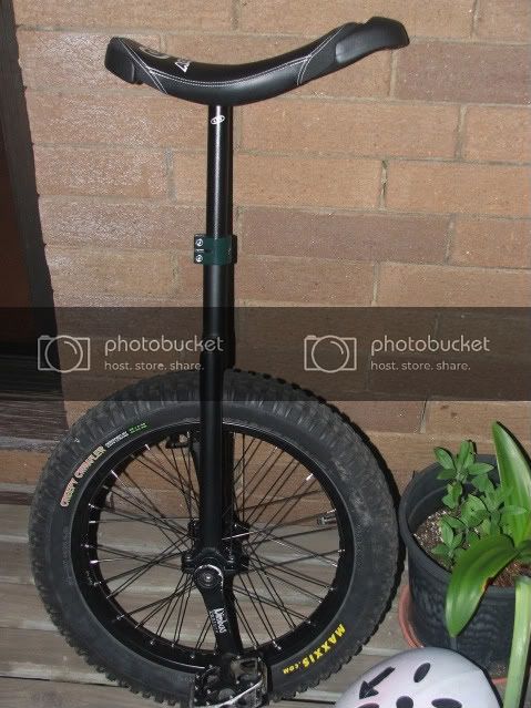

ok i finally got around to putting my new aDDict regeant frameset* onto my uni and to my horror, the spokes were rubbing against the frame, just above the bearing holders on the frame. this was then followed by an hour of filing and fitting. i have just got it right.
Just a warning to other unicyclists who are gonna fit a nimbus hub with aDDict frames.
Other than that, my uni feels SO light now! props to aDDict/impact unicycles for making a awesome frame!
*frameset= saddle, post, clamp and frame.
Pics? :smiley:
yes later, trevor… later. depending on if im having too much fun with new light uni.
ISIS hub BTW.
