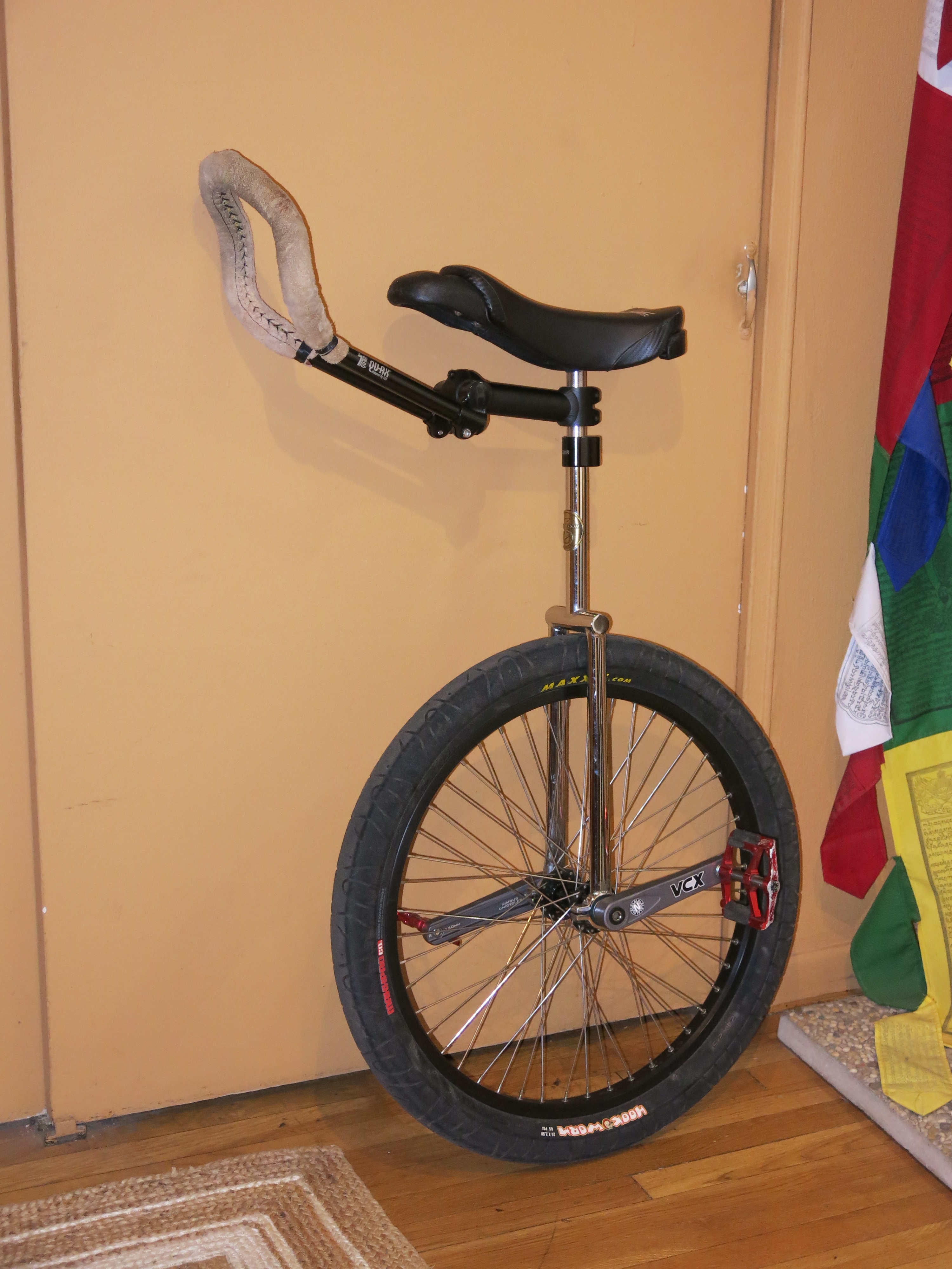

Can you post a picture of the unicycle that you have? As Nimbus have made a number of slightly different unicycles over the years it would be good to know what we’re talking about here.
It sounds like good news if it hasn’t shifted again. It sounds like the spokes could perhaps do with being done up rather tighter than they are/were if nothing has shifted as @saskatchewanian suggests. Modern spokes can typically handle being very tight, and they’re generally far more likely to break being less tight permitting more uneven tension between them when force is applied to the wheel.
Here’s a pic. As for spacers, I do not recall any when I changed the bearings. Still, I just popped the wheel off the other day and it was in rock-solid. It is not dancing around.
Ahh, you’ll likely want to fix that to prolong the life of your cranks if nothing else. It’s pretty easy to over tighten them and deform the ISIS interface without a positive stop.

Thank you for the suggestions. It is true, I do have one crank that I have to keep on tightening. I am ordering spacers ASAP, I ope I did not ruin that crank. Also, does anyone know what size and pitch tap I need to clean up the threads inside the Isis axle? I mashed them a bit last time I used the crank puller.
