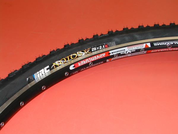

I have this 24mm wide Alex Adventurer rim on my 29er. It’s laced 3 cross with 14mm DT spokes. Nothing fancy but seems to do the job.
Steve Howard

The Alex rim is only 17.8mm wide (inside width) but 24.2mm wide on the outside. Not quite as wide as the Rhyno Lite.
Rim widths are strange. Sometimes they quote the inside width and sometimes they quote the outside width. Nobody (not even the manufacturers) is consistent in which number they quote for the width of a rim.
