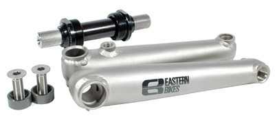

48 spline Titanium axle and cranks
Has anybody looked at these? I did some searching for Titanium cranks and looked on bike forums and bounty hunted these. There were some talk of others that weren’t out yet, but these look good.
1.3 lbs!(axle and cranks combined) Profile’s hub and cranks are something like 3 lbs! You save tons of weight with these. Think of the Trials uni, or Muni you could have.
48 spline, will fit profile axle.
They look pretty sweet aswell
So for all who want to overhaul your Profile hub and cranks, and make your rig much lighter. Giv-it with these! You’ll shave off 2.7 lbs! If you have a profile hub and cranks in already.
The final price of this axle and cranks = $440 U.S. Not terribly expensive, but up there. I really want a pair. The bad part is, if you did break them you lost alot of money. But they are Titanium, so they should be pretty strong. And from the few reviews I saw it was nothing but good. They appear to be thick enouph to take abuse without snapping like some other Ti cranks have in the past.
Here’s the real website. Go to cranks and you’ll see them.

could you lace a wheel to that hub? It looks like it does’nt even have flanges.(Correct me if that was stupid):o
it’s for a bmx bike. it’s not supposed to connect directly to the wheel like a unicycle.

If you use the spindle that come with them surely it needs some kind of machining to make it fit inside the profile hub?
Ah yeah, it’s obvious you’d need a hub. The axle and cranks are whats good on it. That axle slides into a profile hub.
Yeah, everything you see obove is supposed to fit profile’s stuff. If you want to use these Ti cranks with your old profile axle/hub, then you can. If you want to take out your current steel axle from your profile hub and put this Ti axle in it, you can. Or if you want to change your profile steel axle out with this one, and use your steel profile cranks on it, you can. Or you can replace everything out of your profile hub and get these Titanium cranks and axle.
Make sense? Everything should switch out with the 48 spline profile setup.
Danni, I dont think so. I havn’t found any 145mm Ti stuff.
Wouldn’t you need to custom make a spindle for the Profile hub?
I mean, a bike spindle probably isn’t the same length as a unicycle axle.
You would also have to make the axle a key, because it would just spin freely in the hub if you didn’t.
So basically what I’m trying to say is, you have to custom make a Ti axle for a Profile unicycle hub.
I know there’s 2 different lengths you can buy this axle, but I dont remember what they were. But Im pretty darn sure it’s the same as “our” profile axle length. If it didn’t work, Profile has a titanium spindle that would work anyway if you wanted to change it out. Im also pretty sure both of the spindles (Eastern Bikes, and The Profile Ti spindle) have that key slot in them.If you look at the above picture it has to have a slot in it anyway for that bike hub piece to fit on without slipping. The pictures just dont it. Ive read reviews, and they all say the Eastern Bikes 48 spline stuff above all fits with profiles stuff. It should all work.
Or it could be pressed on.
That metal piece around the spindle doesn’t really have to turn, if it’s pressed on it’s fine.
that’s true. but I think you are right about the spindle length. Ive looked at other Titanium spindles, and they either come in 5-3/4 or 6" lengths. Our unicycle spindles are like 6-7/8". So I take back what I said. I dont think these Titanium spindles will work in “our” profile hubs, but the cranks should still work.
