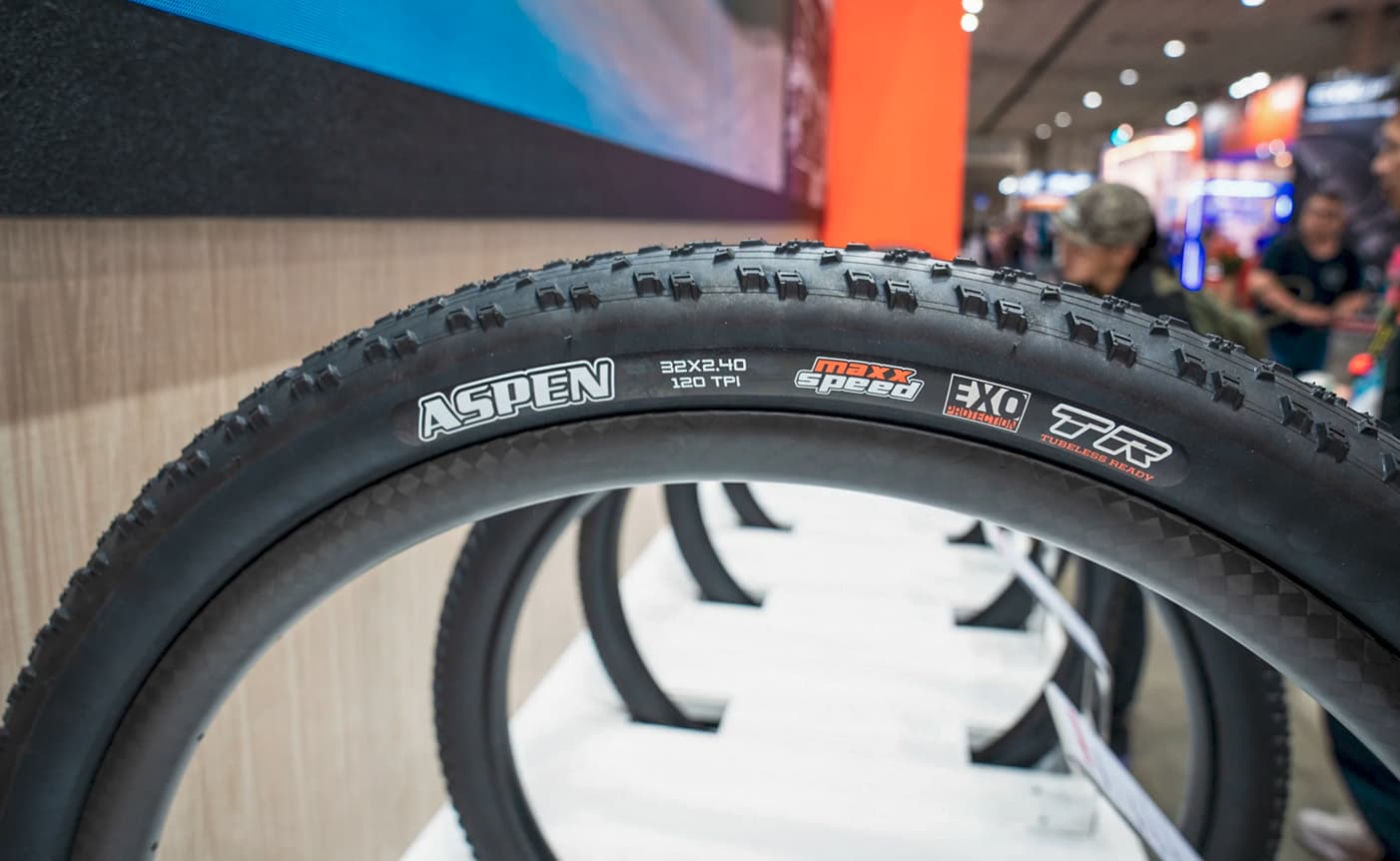

So it sounds like the Maxxis Aspen 32x2.4” tyre will be available to buy before the end of the year, with other 32” options coming from Maxxis not that long after, and I wonder whether it’s what we need to get 32” unicycles mainstream.
For so many riders I maintain they’re a better option than a 36”, and that will be even more the case with lightweight kevlar bead tyres. I think so many riders go to 29” and then feel 32” is too small of a gap, but I similarly see many riders struggling with the size of a 36” even when they’ve had them for years.
I’m hoping the Maxxis tyres come in at under £80 a piece, but being a more speciality size it might not. I’m still anticipating it being cheaper than the Nimbus Nightrider Lite, and at probably 500g or so lighter (based on some maths with the 29” Aspen).
Update from the future: They seem to be £60-80 (~$100), and ~825g, so a saving of almost 600g over a NR.

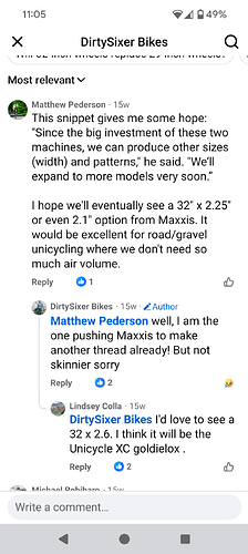

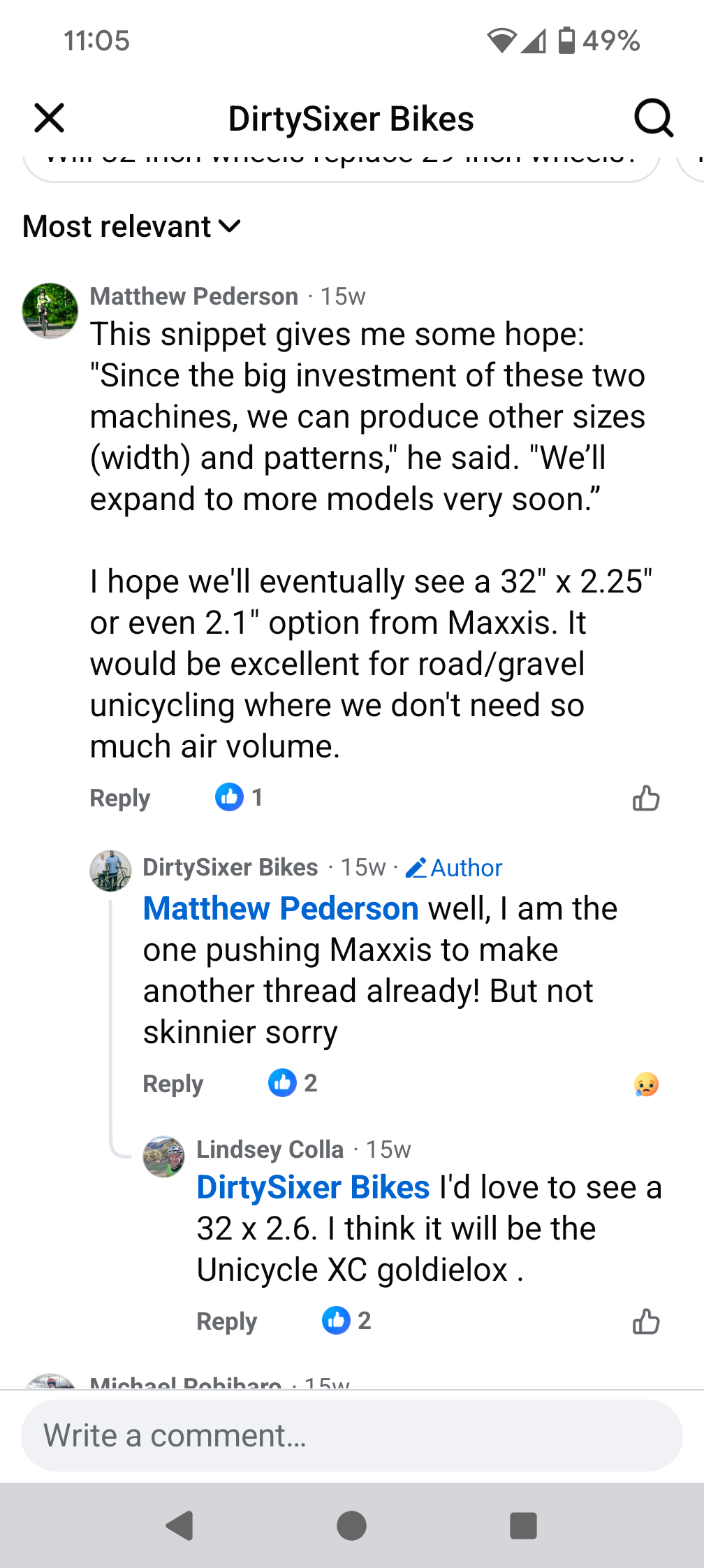

I wish, but I spoke with the owner of DirtySixer a few months ago and he indicated Maxxis is only interested in making wider 32” tires, not narrower, which seems to rule out gravel 32” tires.

For reference, below is my brief exchange with DirtySixer:
Just found this: https://www.bigandtallbike.com/maxxis-aspen-32-inch-tire-32x24-tlr-maxx-speed-exo.html?srsltid=AfmBOor_rouT5WROD2U5_oYcH3Dk78MRmmJU_jkLtpdjL0nQBQ9mF0CS
Seems more like 0.78kg
The Aspen 32 inch tire is a lightweight XC tire that is designed to roll fast and still provide enough traction to keep you going when the trail gets rough. Also great for adventure gravel bikes.
  • Low profile tread design rolls fast and still delivers grip for climbing and braking
  • Aggressive side lugs dig into soft terrain to provide additional cornering traction
  • Intended use: hardpack, loose over hard, medium
  • MaxxSpeed features a high-silica content compound that reduces rolling resistance while also enhancing wet traction
  • EXO casing provides protection on sidewalls for extreme cut and abrasion resistance while remaining lightweight and highly flexible
  • Wide Trail (WT) sizes optimized for 30mm
  • Weight: 1.72lbs per tire
