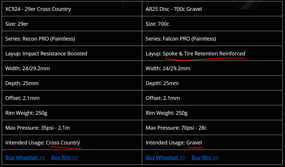

I am most taken by the AR25 (I know copy cat!) and LB have said their reinforced version comes in at 350g ish so still lighter than other options and this is rated at rider weight of around 100kg I think.
However when I checked with LB on using the G-one Speed 29x2” tyre (double copy cat!) - they said for a 29” tyre I should opt for the XC924 but this rim while it appears the same style is rated for XC style PSI - max 35psi.

Riding a unicycle on roads and paths is closer to gravel than to XC, and the tire’s fit on the rim is a point that can be critical for a unicycle (and much less so for a bike).
You have to be careful with pressure: 35 psi in 2.1" is not directly comparable to 70 psi in 28c.

And then LB releases 2 rims based on the same construction: AR25 and XC924.
To me, it’s obvious that LB has promoted these 2 rims by focusing on the differences between them. It’s an obvious marketing ploy: they release a single new product and the consumer has the illusion that there are 2, so different are their uses.
To polarize the characteristics of these 2 rims, they based themselves on the uses and the tires available.
They have nothing to gain by saying that you can use a gravel tire larger than 2". Nobody wants to ride gravel with >2" tires, and these tires are uncommon. Especially since they indicate a maximum pressure for a 28c tire… you can’t rely on it with a 50c tire, so with a larger tire it’s even less true.
As for mountain biking, who today wants to ride a mountain bike with a tire smaller than 2"?
This polarization of the uses of these 2 rims will reassure 99.9% of consumers in their choice. And we are the 0.1% of consumers…
I think the only difference between these rims is a bit of carbon to reinforce the impact resistance of the XC924 version and to improve tire retention on the AR25 version.
It may not even be real, but that’s why I chose the AR25 version.

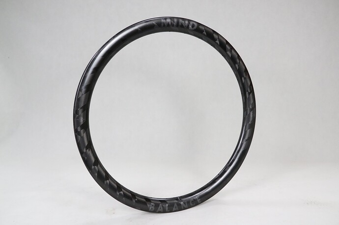

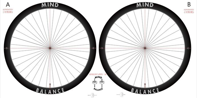

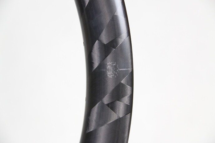

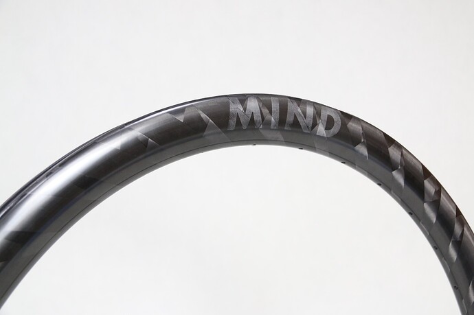

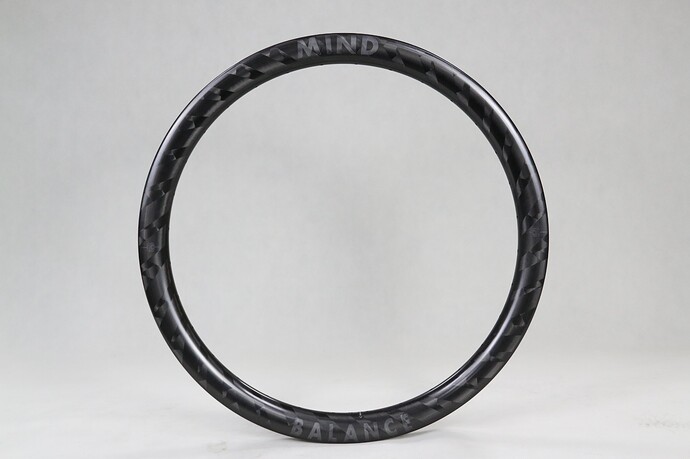

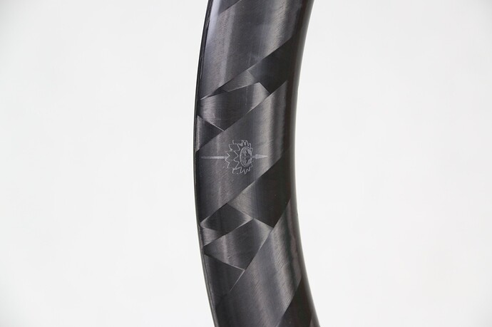

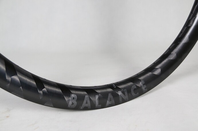

Going to look great in in my view in LB’s UD Braided finish with these geared specific engraving from my tattoos - now on carbon! :star_struck::gear:
Side A - Down Shift Cog - when rim edge is on the ground
Side B - Up Shift Cog - when rim edge is on the ground
Yes a deeper than normal rim and a bit weighty - so not aiming for super light weight - but I’ll happily run 55c tyres with probably TPU or tubeless set up and enjoy the stiffness of this wheel when I track down some decently car free(ish) tarmac lanes :soon:
This is a thing of such beauty! :star_struck:
