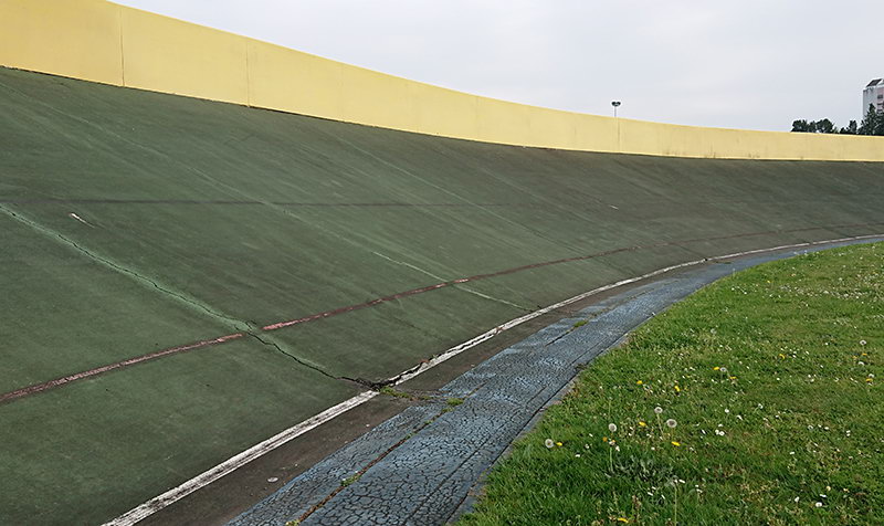

I can now handle very low camber on left side (like on the first picture), but on flat road it still feel like a left camber, and I need a right camber (about same angle than the first pict) to feel like a flat road with my other unicycles.

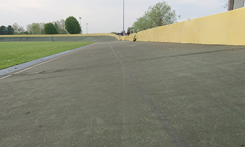

On right camber it didn’t changed, can still handle low/medium camber like the next picture but it’s tiring, on 1 or 2 miles it’s ok, but on long rides it’s hard (while with my others unicycles I can handle 15 miles without problem).

Oh, that’s what you were asking about! Somewhere deep in the archives here are a few reports from people who’ve tried unicycling on banked velodromes, and none of them had a good thing to say about it. We don’t go nearly fast enough for the banking to help. At our speeds, it tries to make a unicycle turn the wrong way. All reports said that it was very awkward and uncomfortable.
On the other hand, riding a proper track bike on a steeply banked velodrome is a real kick. I’ve only done it once, on a track with the turns banked at 42°, and I can’t express how much fun it was. We were told to keep our speed above 12 mph/20 kph in the turns or else we would slide down the wall!
