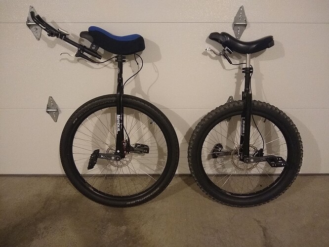

This is a link to a photo of my 26er muni next to my 29er road uni .
you can see there is not a great deal of difference in size.
httpss://photos.app.goo.gl/XYuM98FuYUCGzyFt8

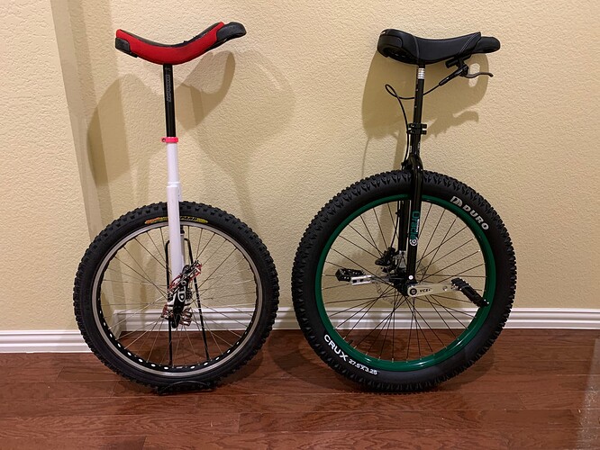

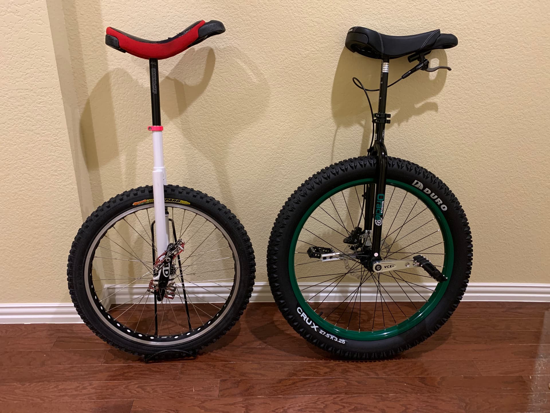

I had the same decision to make. Your profile says you already have a 24” Oracle and a 36er.
Here is a photo of my 24” Koxx with a Duro 24x2.6 Leopard tire (It measures 25”), compared to my Oracle 27.5+ (it measures exactly 29.25 inches).
I went with the 27.5+, since 26” is not much of a difference vs the 24”, AND since the Oracle 27.5 frame was designed to accept the Duro Crux tire that measures 29.25”, it will also take a 29” wheel, as long as the 29” wheel does not have the 29x3.25 Duro Crux installed.
So, my plan was to ride Muni with the 27.5 Duro Crux, and to build a 29” wheel with a Maxxis Hookworm 29x2.5 to use as a road wheel.
That is my perspective. If you wanted a little more flexibility (and size), the Oracle 29 has the Duro Crux 29x3.25, which should measure close to 30.5”.
Thanks, this picture is very helpful!
