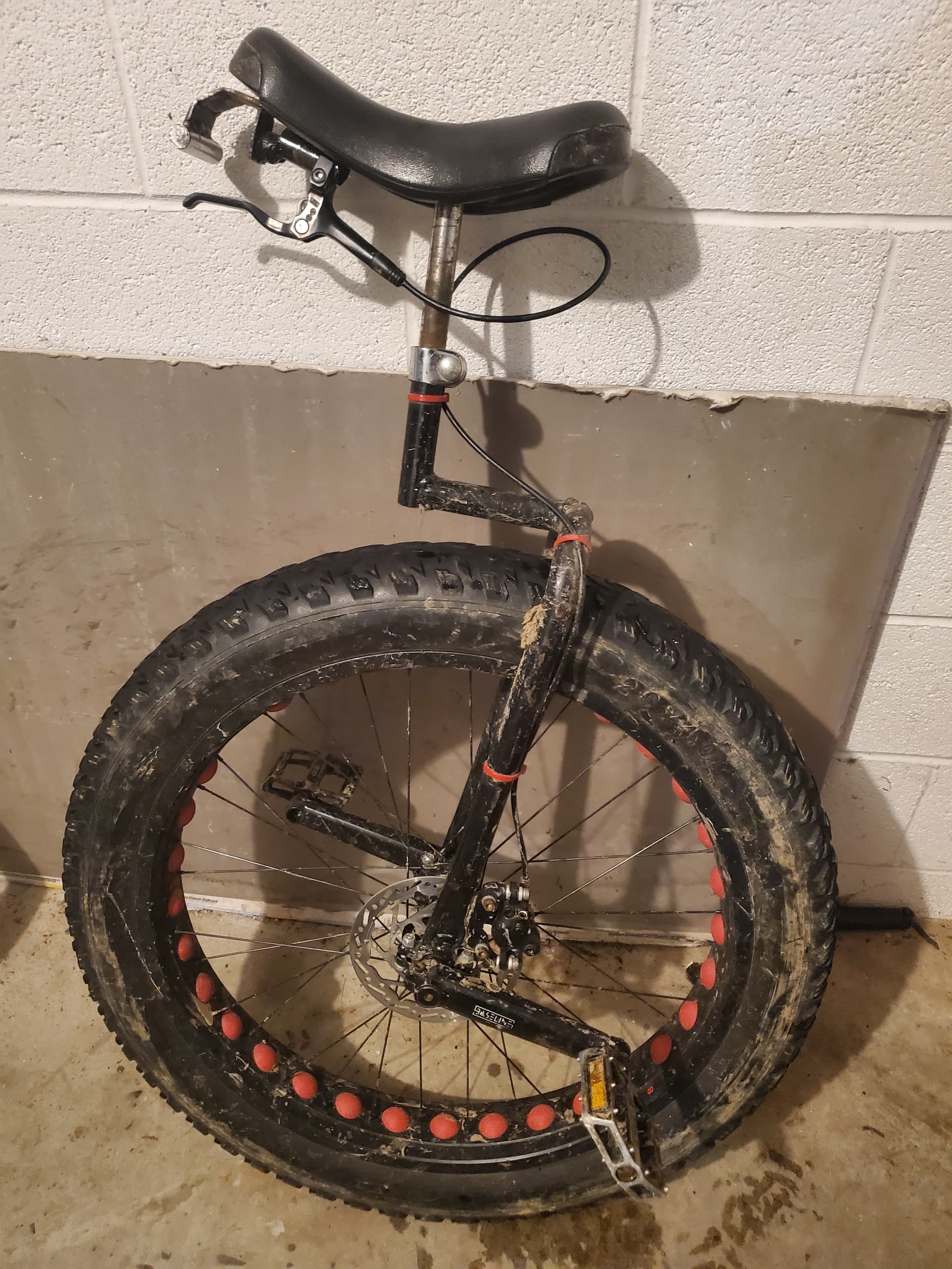

Can we see pictures of your frame / uni, pleaaaaase?
We went to a local bike shop and got a 4 in wide bike rim and i made some bushings to hold a bmx bike shaft and built the frame around it.Im trying to decide if i want to try studding the tire.
Hatchet style, looks really cool! If I was you I‘d look for a more modern seat post clamp, though
. Your frame is not as massive as the Hatchet‘s - do you feel any flex caused by the horizontal part of the frame?

I should have said we get a rim and tire.Im not sure how wide the rim is.I never felt any flex.I would like to make it out of aluminium.
