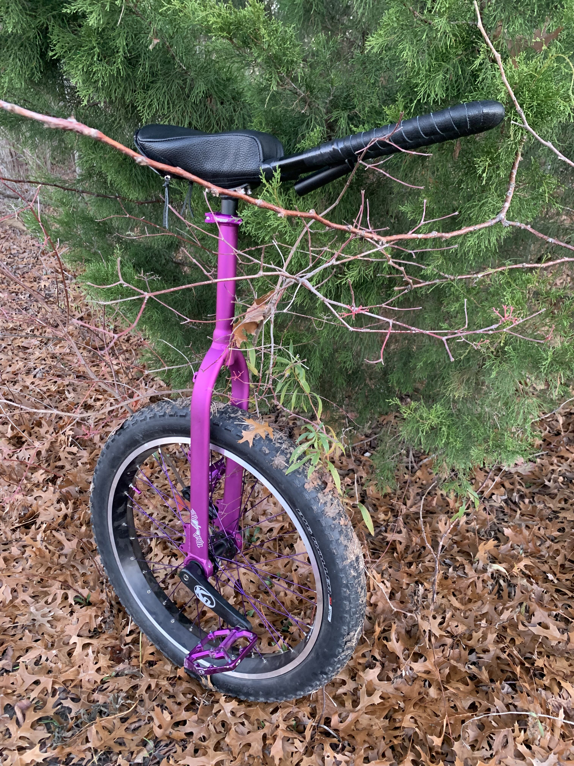

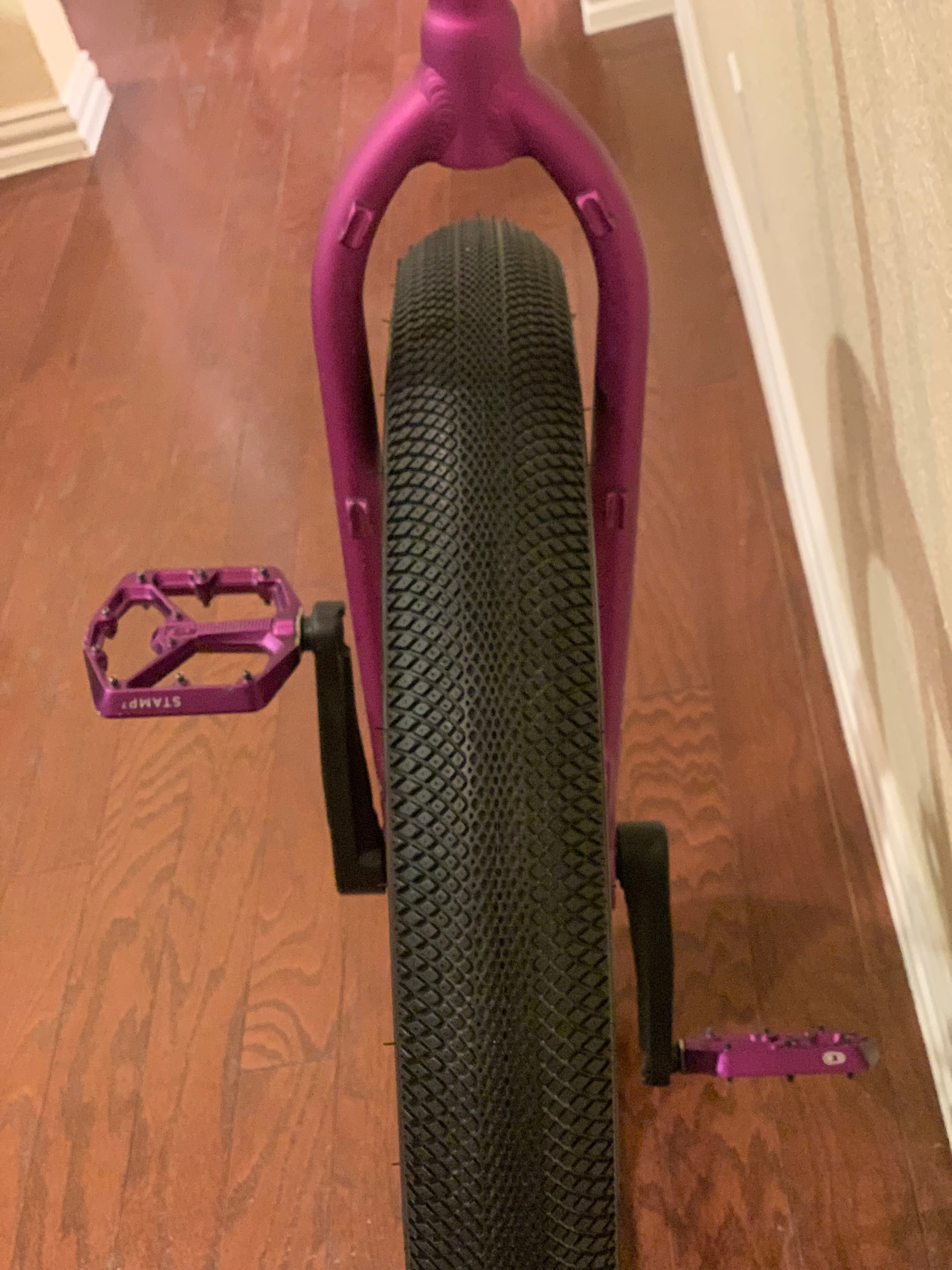

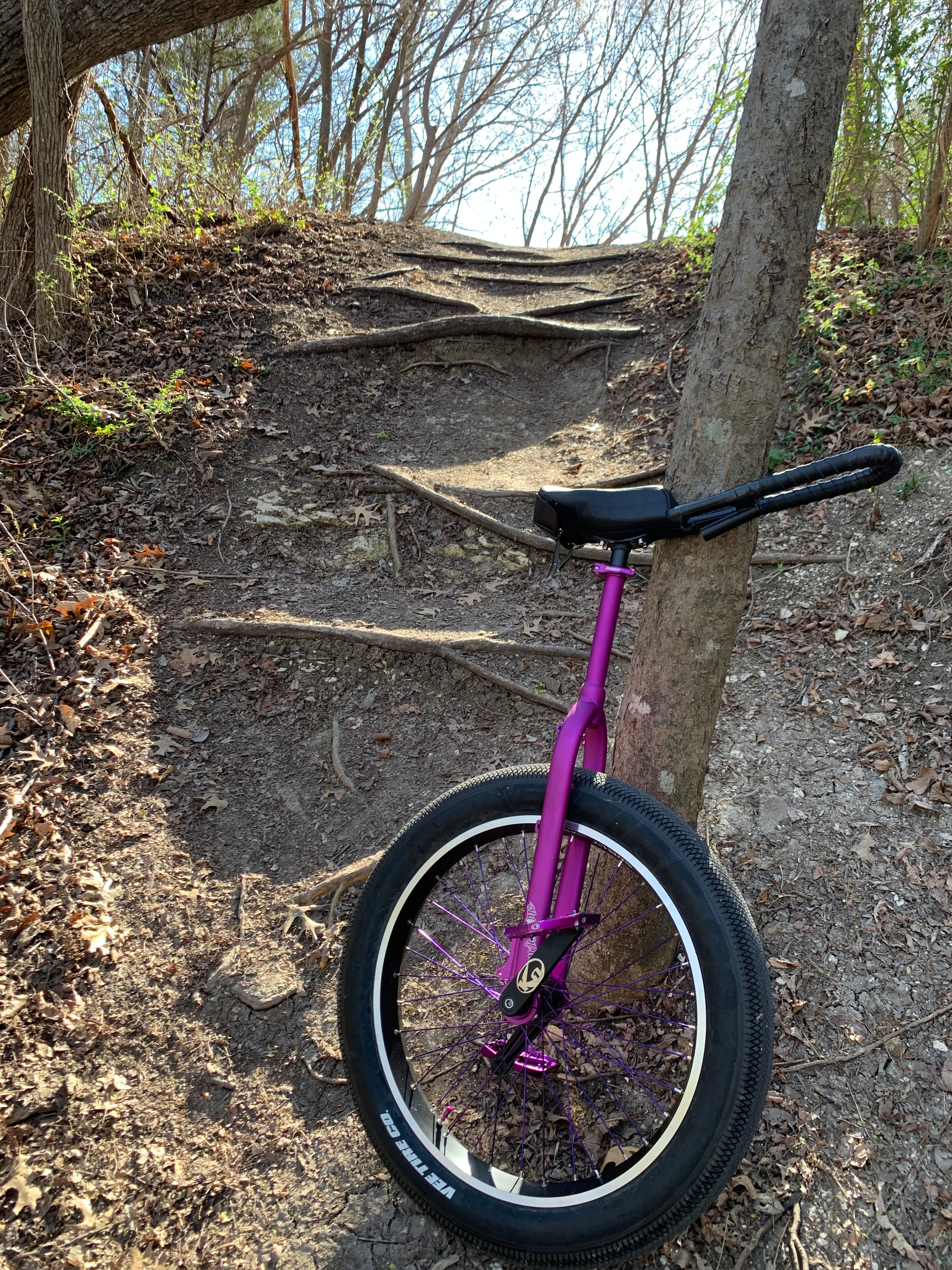

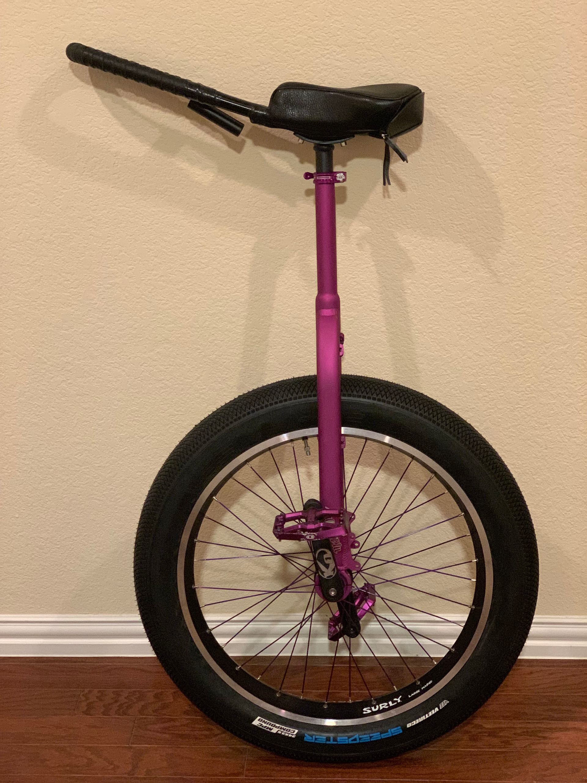

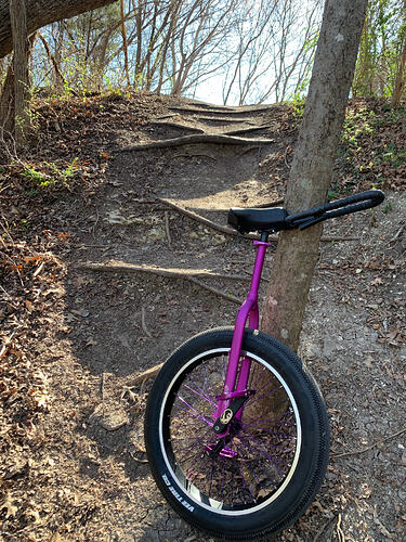

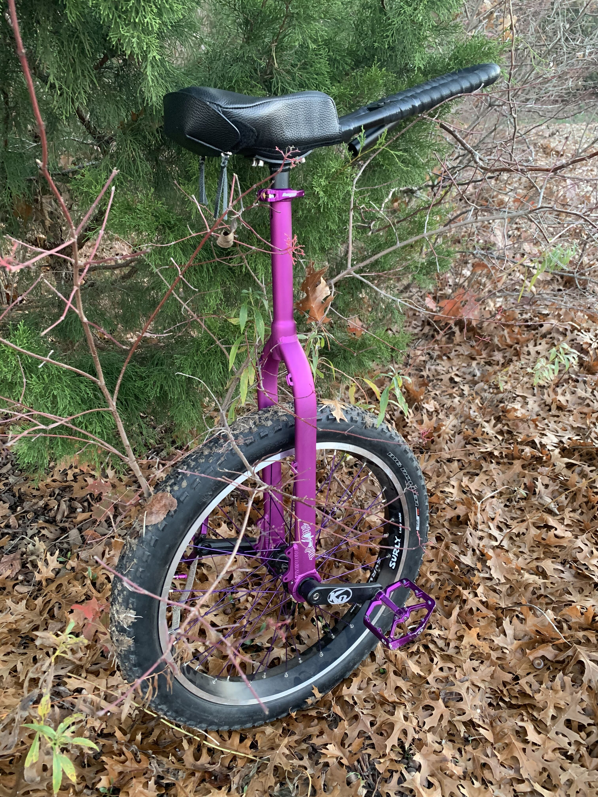

I have a little different take. My M4O frame/Large Marge 24” unicycle has become my choice for most rides. However, I do not ride with a 4” tire. I started with a 2.8” Specialized Big Roller, which worked great. Then, I switched the tire to a Vee Tire Speedster 24X3.5” tire. That tire is wide enough for me. In the photos below, you can see that I normally don’t use the full width of the tire. But, the fat tire DOES make the diameter closer to a 26” tire, and the fat tire does act like a suspension system.
The only time I have lost traction with the Speedster tire was this past week when I rode after a day of heavy rain. I rode through layer of mud that was covering a cambered sidewalk, and the tire “floated” on the slippery mud. That happened twice. I was able to control the slide and step off into a light run each time.
