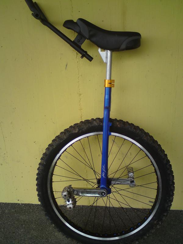

yesterday i got the 26" wheelset with a 3.0 tire, put it in my 29" frame, put the 09 saddle and handlebar on it and went for a ride! it’s for me the perfect downhill and freeride uni (handlebar is not really necessary but for uphill and cruising i like it), i just sold my 24" :astonished: i live in the alps, and i think with enough power in the legs you don’t need brakes on the 26" ( and of course not on the the 24"), i go with 150 cranks. i like most the speed i got with this setup and still good control and also drops are possible.i’ll try also different tires (2.5 or 2.6) i also own a schlumpf (was on the 24" now on the29") and of course turtles V which is still fine for crosscountry.

Hey Kris, I just had one more thought about the 26x3 frame issue:
Wouldn’t the the 2008 model of the 29" frame fit pretty well with its lowered crown (my 29" frame is a 2007 model and has a lot of tire clearance with the 26x3 Gazzaloddi)? So maybe you wouldn’t even have to design a whole new frame for 26x3ers, just put the brake mounts in the right position or come up with some adapters. Wouldn’t that be a real quick and easy solution? Because I really don’t want to buy a 26" frame that doesn’t allow for a nice and fat tire. If the 2.6 Gazza fits, then maybe, but so far I didn’t hear any confirmations about that.
Waiting until 2010 seems so unbearably long to me, and then there is still no certainty that the 26x3 frames are coming out at all.

Hi Christian,
I’m curious, and I apologise if you’ve already answered this elsewhere (I’ve looked a little) - why are you so insistent on using a 26x3? would a 26x2.3 not work for you - have you tried?
I do understand that you want to stick with what you already know and like of course!
Cheers
Mike
Hi Mike,
First of all I already bought a 3" Gazzaloddi together with a couple of expensive DH inner tubes and a 2.5" Hookworm tire when I was determined to go 26" with the KH/Schlumpf (None of these would fit in the 26" frame). At that time there was not the slightest sign of a KH26 coming out at all. So I was going to have some brake adapters made by a friend for my KH29 frame. That turned out to be somewhat complex and he was not very keen to help me out, so I decided to go brakeless until a better solution would arise. Then the announcement of the KH26 frames built up some high expectations. I was really sure to be able to use all my tires etc. And then the disappointment that it wouldn’t take large volume tires. So I decided against buying the new frame now because I want to have the option for big tires. I’ll just keep using my 29" frame (from 2007) with the Gazza and the Hookworm. I even might be better off getting another KH24 with gears and a 3" tire than with a 26x2.3. The circumference would be similar anyways. I just want the bounce, suspension and traction coupled with the large circumference of a fat tire. Maybe not always, but the option has to be there. Should I decide to go with a 2.3" sometime I will be able to live with a little more tire clearance anyways. It would be similar to the clearance in the 2007 models, which I find quite acceptable.
I must admit that I haven’t tried a 2.3 tire on the 26" rim yet. But I know it will have less suspension, less circumference, less traction and less fatness. No doubt it will be lighter and more agile too. But as I said, with a slightly higher crown you still have that option as well. If the new frame could take a 2.5 hookworm and a 2.6 Gazza I would get it with no hesitations at all… I know from my KH29 that 2.3 is most definitely not what I want on a tech muni. That’s okay for xc though.
Boy, that was a long one. I hope you understand now.:o:p;) :sunglasses:
