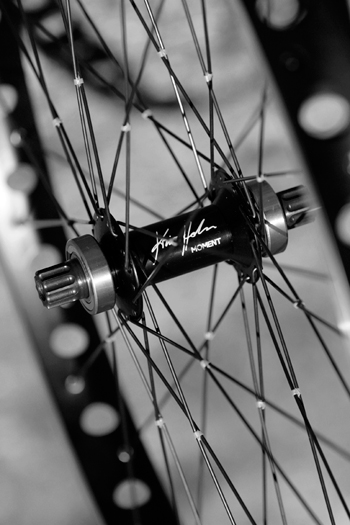

Ah, thanks. Does it help with lateral tension then?
I think, I would need some kind of actual data to back that up. I just know that bigger flanges + wider hub = stonger wheel.

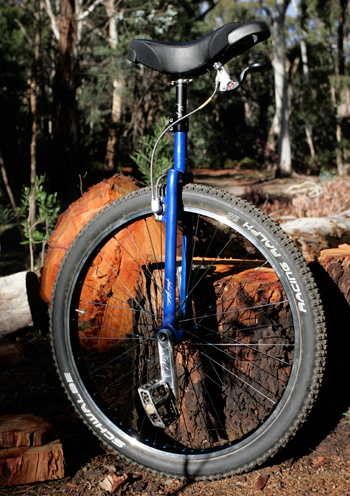

Collected my 29" freeride wheel today. Unfortunately I could only fit in a short ride but first impression was that it has more of the stability and feel of the KH24 vs the standard rim. Nice as that’s the main thing the 29 lacked.
I’ve posted more notes and pics in my blog
http://unplannedismounts.com/2009/04/30/kris-holm-freeride-29-project/
Hope to do some back to back rides in the next couple of weeks, on the standard rim then freeride rim, as well as try out a couple of the tires I’ve got here. Look forward to hitting the trails tomorrow and over the weekend!

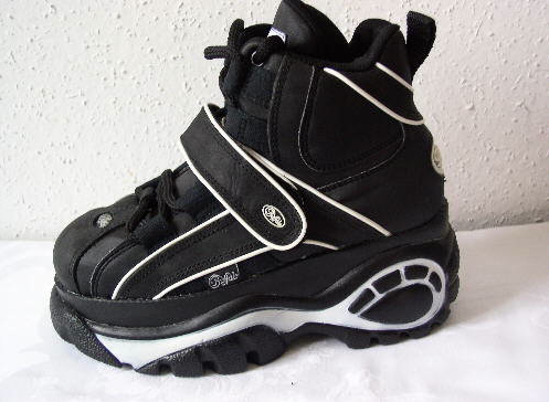

Well, it also depends on the crank length. For longer cranks you’ll have to have a lower seat than for shorter ones. So maybe You’d be fine with shorter cranks. If you’re not going offroad anyways, shorter cranks like 137mm or 125mm could be a good choice. Another possibility would be plateau shoes like in the picture below:p. But cutting 1/2" off the frame might be a better idea after all.:wink:

Kris I’ve had some great rides on the 29er with the ‘freeride’ rim. It feels like a dedicated off road uni now, a big brother to the 24, which is a blast. I’m probably going to swap back to longer cranks on the 29 and try some of the harder trails I’ve avoided in the past when riding the 29er.

Some extra pics, video and info on how the new rim is going
http://unplannedismounts.com/2009/05/02/kris-holm-freeride-29-road-test/
