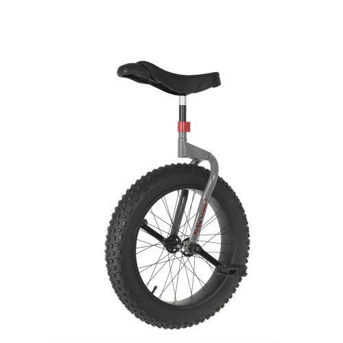

Ok, how the hell did I miss this? Have we discussed it already somewhere?
As far as I can tell this is the the old 20" Nimbus Purple monster unicycle but now with a cute :heart_eyes:, downsized Hatchet-style frame. That does however mean it has cotterless cranks rather than ISIS and no brakes nor a straightforward way to add them (though brakes on a 20", even with a fat tyre like this, is perhaps an overkill anyway :person_shrugging:t3:).
Despite being relatively low spec, that Hatchet style (in mini form) still looks great and since it is pretty cheap, I am sort of tempted anyway. I had already looked at the 20" monster before as a fun little thing.

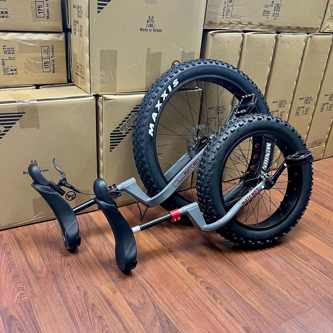

But the US website already has it. Indeed one of the guys I follow on Strava (Paolo Unitoonist) is already riding around on one (which is how I found out about it [from his pictures])
Edit: Image stolen from Josh’s Instagram account, showing the new 20" lying in front of the 26"

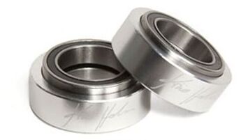

A couple of years back when those 40mm ISIS compatible bearings were still for sale, I considered buying them. Not because I needed them at the time (I owned nothing I would use them on) but more as a, “you never know” :thinking: kind of purchase. I kind of wish I did now. :wink:

Yeah but that would require a new frame to house 42mm bearings (since this frame can only accomodate 40mm bearings), or some special bearings like the Kris Holm ones I linked above that can be used on ISIS hubs but are only 40mm. So basically this is a non trivial change.

Thanks, I stole one of his images (the side-by-side view) and added it to the first post (above). I figure he probably will not mind as it is effectively promotional anyway. :person_shrugging:

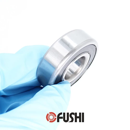

Seems you can get 22x40x12mm bearing if you really want to, making an ISIS rebuild possible.
I assume these will fit:
Interesting. That looks like it might have potential

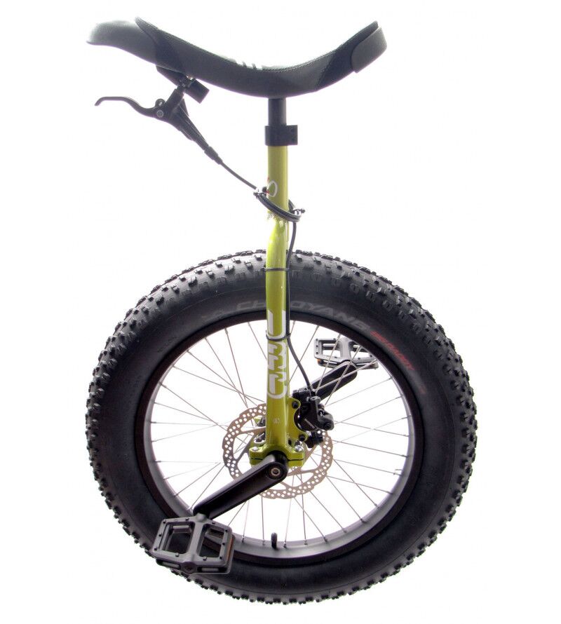

If you really wanted a “mini fat” uni that you could abuse out of the box, it would probably make more sense just to buy something like this:
https://www.mad4one.com/gb/muni/437-20-mini-mountain-unicycle-fat.html
Indeed the unique frame design on the Hatchet matters less on this little Hatchet because the wheel is so much smaller, so you probably won’t hit your knees much anyway, especially as 4" is the max width unlike on the big Hatchet which goes even wider.
So one think about the M4O fat tire unis, they have narrower rims. I got the 27.5" techno fat and it was a 3.8" tire mounted but was only 3.3" wide.
Not a huge deal and it did ride in snow quite well but something to be aware of if you want the full size of the fat tire. Looking at the frame sizes too you could probably fit it into a regular Nimbus frame.
That same 27.5" fat wheel fit my 29" Nimbus frame perfectly and it’s made me consider building a fat tire 20" in my 24" frame but I need to test how my 24" x 2.8" does in deep snow first.
Fair point about the rim width but even if you did want to get the best (and greatest width) out of the available 4" tyres, rebuilding the M4O/URC fat 20" wheelset with a wider rim would still be less work than what you would need to do to the 20" Hatchet to bring it to peak performance, since the Hatchet would need a rebuild anyway to gain an ISIS hub, plus you need to get hold of usual/uncommon/untested bearings to fit the frame and you are still left without the possiblity of a brake. Oh … and the frame on the Hatchet is unlikely to be as strong due to the unusual design.
So starting with the M4O/URC fat 20" it is less work to get things “perfect” and if you can accept the smaller rim… you don’t have to do anything at all.
