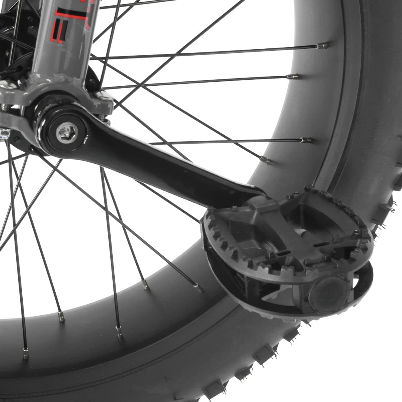

Not sure I would consider this Uni for adult use. Take a close look at the bearing caps - They are stamped, not forged and machined.

I would not consider those bearing caps to be a strength problem, as lots of unicycles for adults have stamped bearing caps. All the URC models from M40. Here is one for example:
https://www.mad4one.com/gb/muni/435-26-urc-mountain-unicycle-fat.html
Other brands too. Here is the ONE4ALL Fatty from einradshop:
https://www.einradshop.ch/einrad-kaufen-schweiz/26-zoll/1822-one4all-crmonster-fatty-expert-ch.html
Or here is an Impact Athmos:
https://www.unicycle.co.uk/unicycles/brand/impact/19-impact-athmos-black-red.html
They even provide a close up image for that last one, which looks very similar to that mini Hatchet close up you provided, does it not?

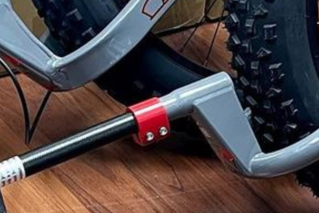

The more I look at this, for me the biggest worry regarding strength would probably be that distinctive frame design. Having an angle weakens things quite a bit. Obviously for the bigger Hatchet this compromise was taken to help accommodate those massive tyres while still leaving clearance for your legs. But then the frame is pretty bulky to help counteract this, so it is not really a problem. I have never heard of anyone breaking a Hatchet frame.
On the little Hatchet leg clearance would be less of an issue for an adult because of the reduced wheel size and slightly narrower maximum tyre width. So you just end up with weaker frame with no major benefit (at least not for adults). Also it does not look anything like as solid or bulky as the big frame at that joint.
Therefore from a functional perspective the original purple monster would actually be better for an adult. The baby Hatchet might be more visually pleasing given the fun tribute to the big Hatchet but you are clearly paying for it in strength.
Maybe it is still strong enough. I am not skilled to judge but I have seen images of much more solid looking frames broken, so that would be my worry.

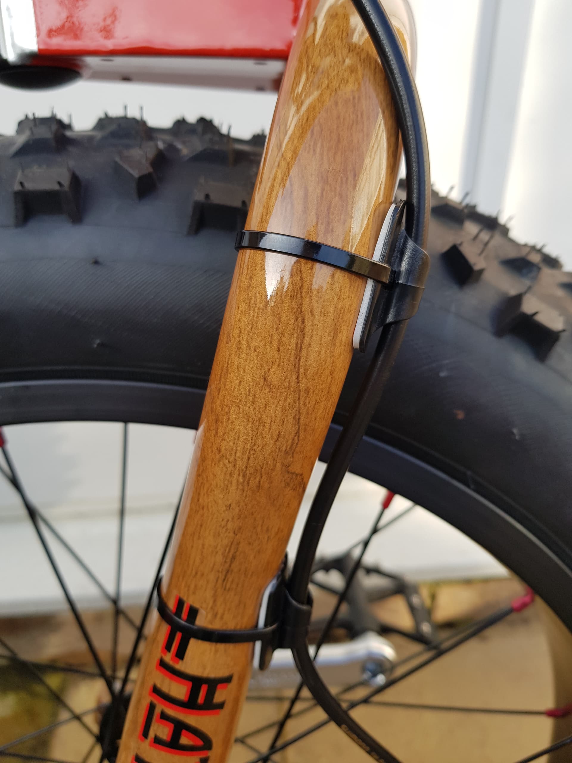

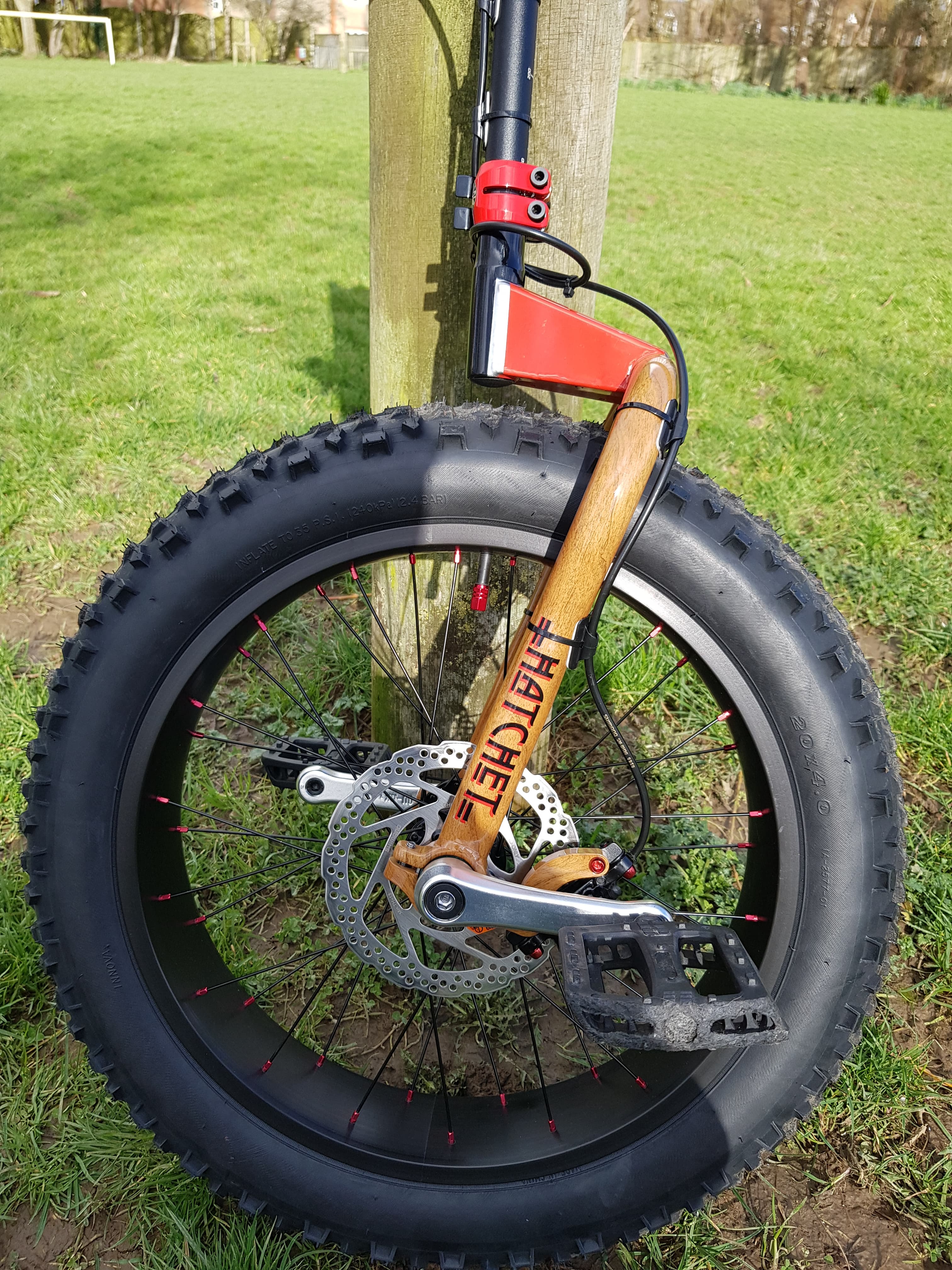

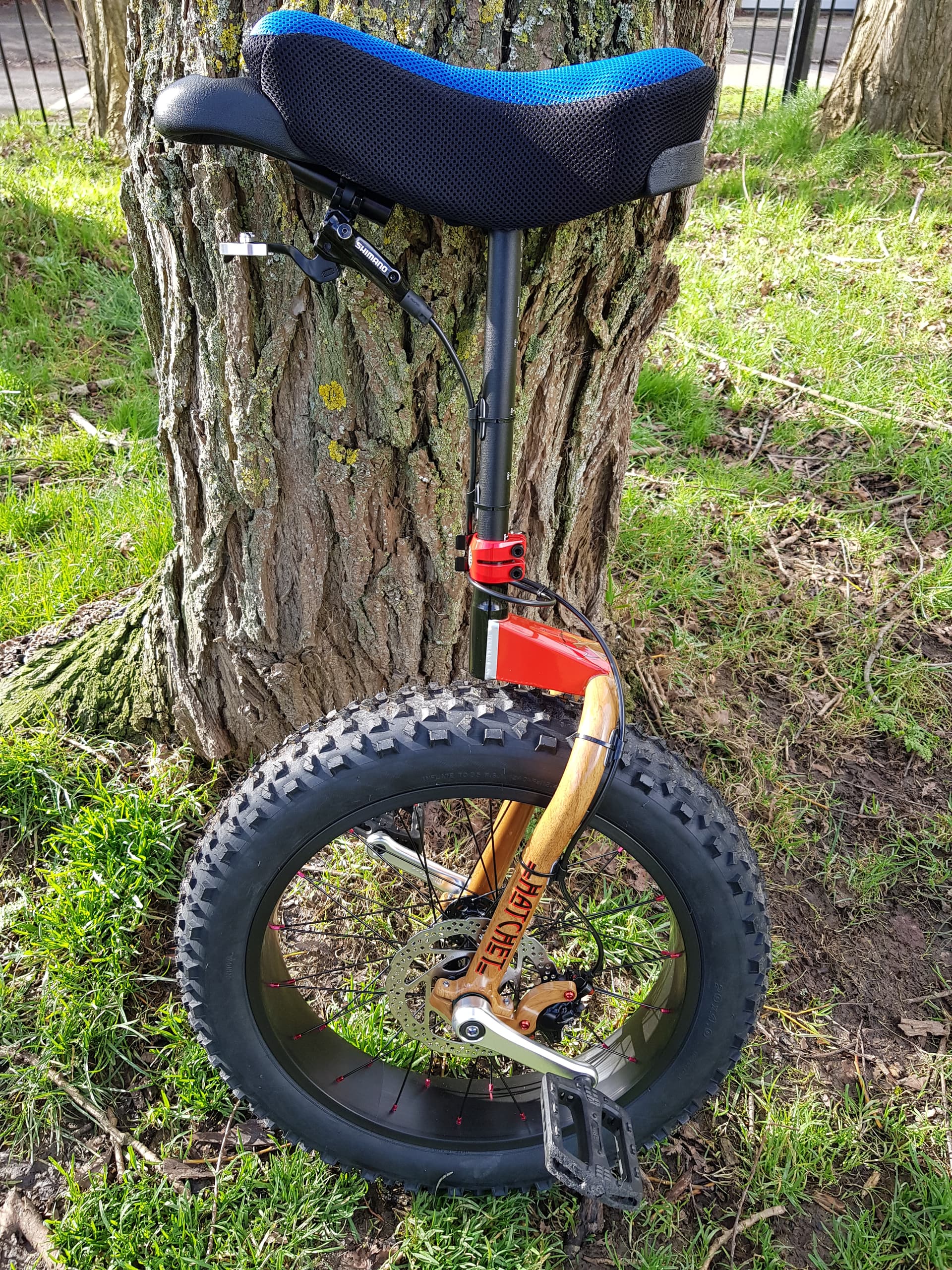

Hello everyone, I thought I would share these. Mini Hatchet ISIS Brake conversion, with D.brake, 160mm rotor, full Nimbus spec, bar the cranks. Hatchet hydro dip paint job. Yes you can still get 40x22x12mm bearings easily enough. Although machined bearing cups is the route I went down.
Wood effect hydro dip with wood grain, it look awesome
