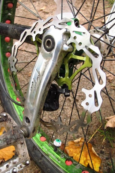

Bad fall during a technical DH, the rider hit the rotor on a northshore, bend it 90° and we had to break it so we could continue riding…
thats a floating disc and must have been a big hit and unluckily at a bad angle to pop it out. Doesnt appear to be a Hope so quality is questionable. The clarks ones are terrible imo
