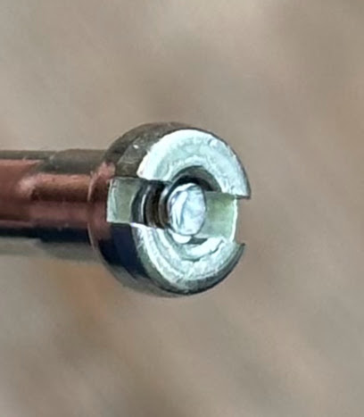

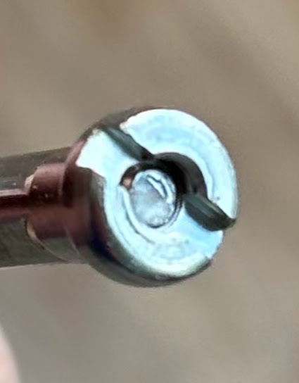

You can remove the rim tape and have a look at the nipples from inside. If there are still a bit of visible thread (like below) inside you can reuse them without issue.
If the spoke is already flush with the bottom of the nipple like below then I would add some “nipple washers” to add a bit of length so the nipple does not “bottom out”.
And if the spoke is already protruding a bit from the bottom like below you should probably just get new spokes as they are already slightly to long.
