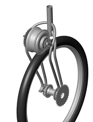

Starting here is the CAD idea that I had going into the project. The goal was to make a frame that was stiff in the direction of the chainline, since I learned from the 3-speed build that if there is much flex under chain tension, then it makes things more prone to chain skipping problems:
