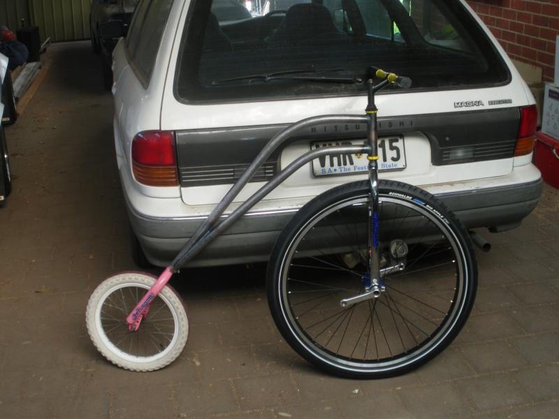

I’m also making a mini penny at the moment, 29" front wheel, 16" pit bmx front wheel on the rear (32h hub/rim, and a chunky axle so I can run pegs on the back wheel).
I was toying with the idea of running a unicycle wheel in the rear, so I could ride it like a uni on the rear wheel, but I didn’t fancy sacrificing my 12" dodger uni in case it didn’t work out.
The frame design is slightly different to Tony’s, to avoid the issues he had with welds breaking etc. My design has 2 tubes coming from the head tube, and tapering into one at the base near the rear fork. I used a UDC 29er fork for the front fork, and replaced the section above the crown with the steerer tube from a MTB.

As promised, here’s a couple of teaser pics of my mini penny project. It’s almost finished, just measured up the postion of the seatpost today, so that and some rear pegs will be built in this week, and it should be ready to ride start of next week, Yeha!
Will post some more pics when it’s all finished and rideable :slight_smile:
