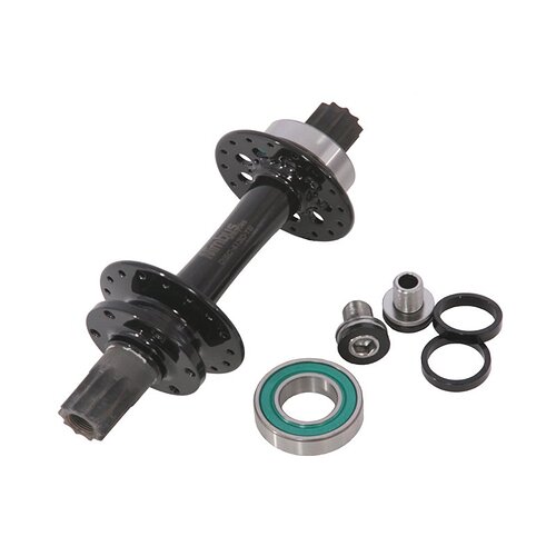

i am looking to build a nimbus hatchet, buying a frame and hub from here in the uk with the hub being a 36 hole.

I’ve been looking at exactly the same and couldn’t find an alternative to the Nimbus rim that seemed worth deviating from unicycle specific components.
So, I got the Nimbus rim and 125 cromo hub, got Sapim strong 2.3-2.0 spokes and laced the wheel last weekend.
Worked a dream, very easy to build a well dished wheel (for a fat rim).

How about buying a 32H hub and get the full choice of rims? As long as you are still in the EU, buying in Germany is as easy as buying in the UK for you. Just a few days longer delivery.
The unicycle world should definitely move on to 32H hubs. I favor Q-Axle and there are no 32H hubs at all available. I also have a Hatchet and could replace the original 26-inch 36H ISIS wheel with a Q-Axle alternative but QU-AX does not produce 125mm-wide hubs either…

I did wonder about just going the 32h route but thought that there was probably a good reason why there weren’t many 32h unicycle hubs… I’m sure a 32 spoke wheel would be more than strong enough for me but it was just one of those doubts that lead to further procrastination (and thinking that sticking with a Dominator rim was probably the safe bet).

Having said that, the Dominator is of course a perfect match for the Nimbus fat hub; the offsets are alike so that the whee isl symmetrically laced.
I got on very well with 254 mm spokes on both sides.
In hindsight, though, I wish I had bought the 125 Nimbus hub in the 32H version so that it fits ā€˜proper’ fat rims … i might still do that if I can’t set it up tubeless … and find out if 32H is strong enough for my 100kg. :stuck_out_tongue:

thanks for all your help and links,i am just adding up costs and wether to order just hub 32 holes from germany and then frame and few other bits from the uk or just do all from germany.my frame,hub,seat and brake mount comes in 13 pounds cheaper all from germany.
ive not decided fully yet on which rim but currently thinking of using a dt swiss br710 26 inch 80mm 32 hole, is that a good choice or any recomendations ?
