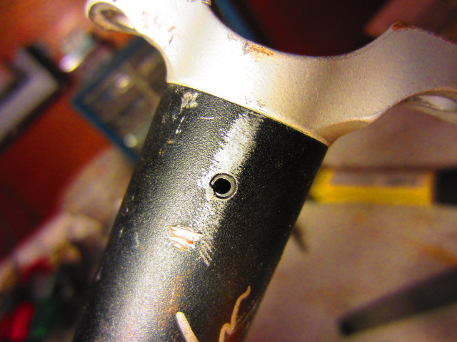

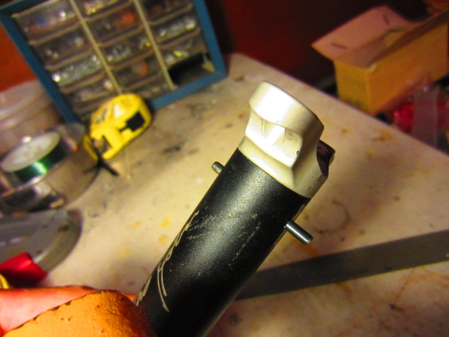

While riding MUni this morning, I noticed my saddle kept turning to one side, so I thought the seatpost clamp was loose. Nope. It was the fitting at the top of the seatpost that was Loose!

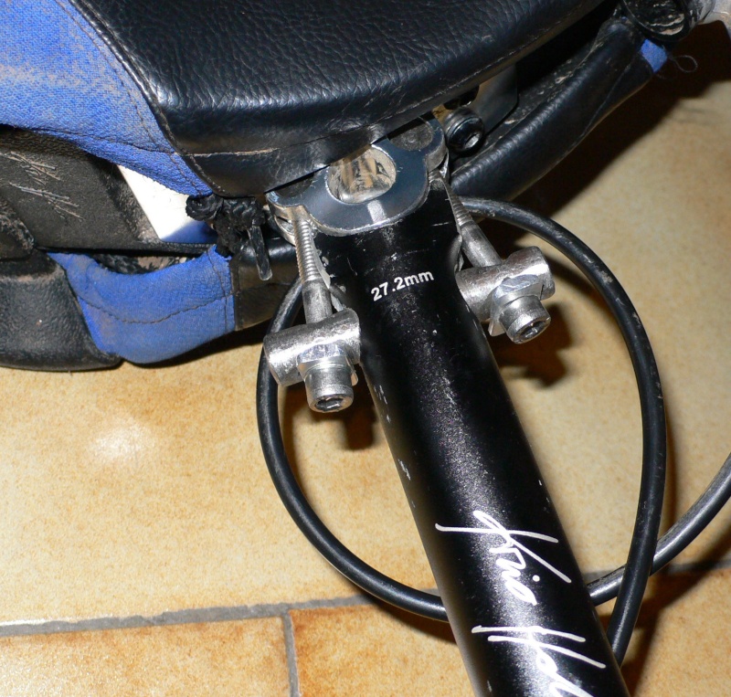

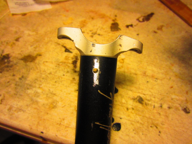

This is the older KH seatpost version with the top piece that is press-fit into the seat post, and although it wasn’t coming out vertically, it was moving left or right. Never had this issue before today.

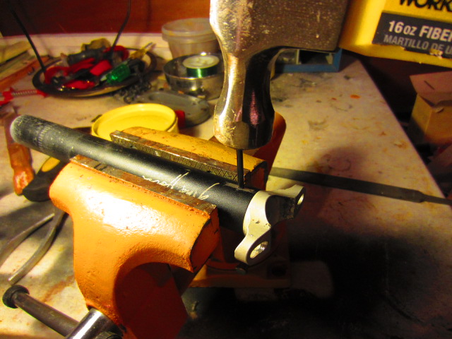

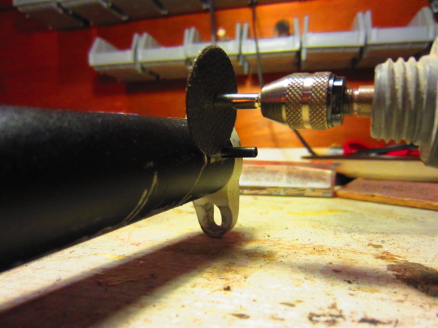

So I decided to drill a hole through it and using Josh’s suggestion, I used a “roll pin” rather than a bolt, so it would be flush with the seatpost. Seems to have worked great and it’s rock solid now. Pics below.
Roll pins are our freinds.
Thanks for the repair photos Terry. I also have not had any trouble with this type of post to date but my unis don’t get near the use that you’re’s do.

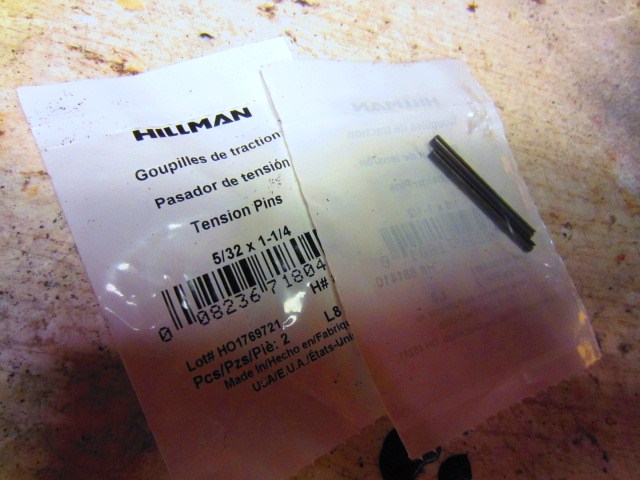

But excuse my ignorance, but what is a “roll pin” ? thanks.
This is a problem that’s been around, Terry’s post is the early version that was only glued, then the later version came pinned as Terry has done.

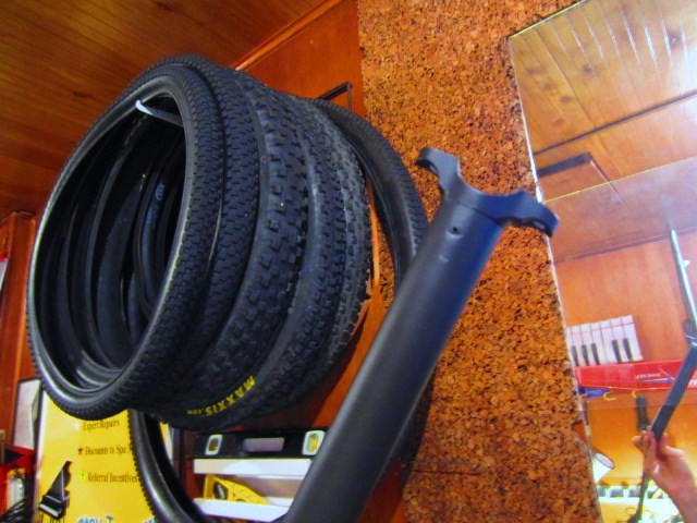

I’ve loosened the pinned version as well, so the real fix is the most recent “forged” one piece post which is sadly only available for 27.2 (KH).
The forged posts are amazing, very similar to a Thompson, but they fit the adjustable base bracket.
Roll or tension pins are a hardened spring steel, split, hollow core securement device used to keep an outer pipe or sleeve from turning or coming loose from an insert that has been placed inside it. A hole is drilled through both the inner & outer parts & the pin which is slightly larger than the hole is driven into the hole & tightens up due to compression.
See Terry’s very adequate photos above.
