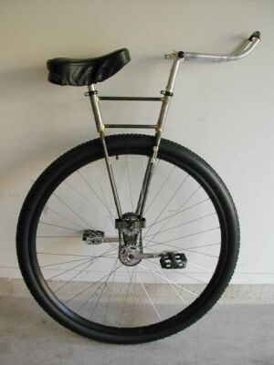

For the past 8 months one of my fabrication projects has been a geared 36". Today I finally completed the first version and took it for a short spin. The 150 cranks seem fine with the 1:1.5 ratio. I used a double 22/18 cog reduction, with a std. 3/32" chain. The hub is a PW track hub & cog. The jackshaft is a couple of track hubs cut & just the cog portions welded together. Adjustment via dropouts & std. chain tensioners. The basic frame was brazed up by Rick Hunter per my “V” design, and I welded on the jackshaft housing. The bars are another custom design of mine. All components are still unpainted, and will likely remain so until I’m satisfied with the workings.

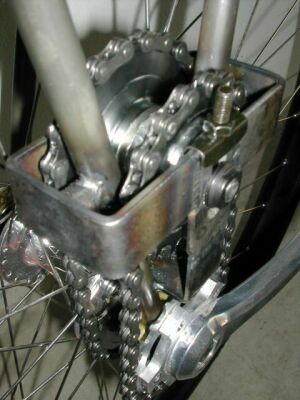

here’s a closeup of the transmission. The hub rotates freely on the axle via 4 sealed bearings.

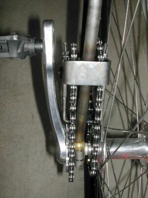

and from the front:
And for what it’s worth, I’m calling this a Geared 36" (tho I do like the “Uber-36” moniker), 'cause the only Coker product here is the tire (not even the tube). I don’t see why we keep referring to these as Cokers, some day there will be another tire choice anyway and no Coker products will be involved… Just my .02
Very very nice…How was the ride?
You should paint it green. Green is the color of envy. :slight_smile:
It will be interesting to find out if it rides better than the internally geared hubs like the Uni.5 and the Schlumpf hub. The jackshaft drive type of gearing definitely has potential. The other advantage with the jackshaft gearing is that you can gear it higher than you can with an internally geared hub.
Now we need some fast riders to come to Seattle and try to break the 1 hour distance record and the 100 mile speed record using your unicycle. :slight_smile:
This may be the machine to conqor the Marymoore Velodrome. Maybe you’ve heard of the place.:slight_smile:

I love the design.
What I can’t figure out is how the two cranks manage to stay in sync. Is there another gear system on the other side, or are the two cranks connected directly? Or is there something else I don’t see?
Great job!
Daniel
Pete is going to have to explain the details of the design.
The basic design is that the hub body is on bearings and rotates around the spindle. It is a one piece spindle and the cranks attach to the spindle. That keeps the cranks in line. The trick is that the hub body is on bearings and is able to rotate faster than the spindle.

Great concept! I notice two chain tensioners. Can the tensions be
adjusted separately without the drive getting out of true? Maybe that
is not needed because both are 22/18.
You probably have to adjust chain tension to hit a compromise between
friction losses and backlash, maybe you can comment on that?

I used twin dropouts and chain tensioners ala giraffe. Only here there are 2 chains. In a perfect world, there would be no chainline issues. But here, even though I did my best to get the cog separation on the jackshaft equal to the separation between the hub and the crank cogs, it seems that so much tension is required to avoid crank play, that the stress results in a ever-so-slight bend of the jackshaft housing. Those that have peered down the chainline of a giraffe know what this means. You want it perfect. I think this arrangement is fine, and I suspect that the inferior chain has more to do with the necessary tension than the cogs. I’ve adjusted so much tension that there’s friction at the wheel.

Daino, John is correct. The cranks are attached via std. square tapers to the 180mm axle (spindle), which is otherwise a smooth and solid stainless steel rod. The Phil Wood company kindly (but for a price) made the longer-than-normal axle for me. The hub rotates faster than the axle due to the gearing.
