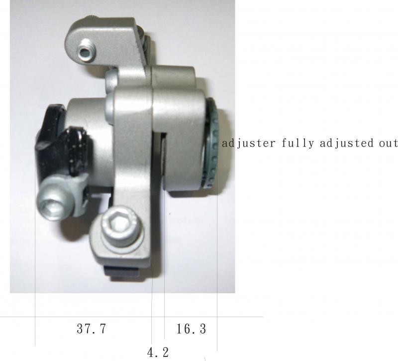

Quad QMD-6
When previously researching options for the Mountainuni system, I wrote to the folks at Quad and asked them for dimensions for the QMD-6 mechanical brake caliper. They sent me the attached photo.
So, does it look like this would work on the Nimbus hub?

@ Unishark: I’ll check when I get home. It looks wide, but without a basis of comparison…compare it to a BB 5/7 if you have one.

Take a look at the Quad QMD 5 and QMD 6, the 6 is like a BB5, might be thin enough, also the Hayes MX5.
I sent the tech guy at Niagracycle a message asking for caliper dimensions.

Wow, this one is a bruiser. It looks like it is really close with the Venture cranks, but should fit easily with KH according to my layouts.
