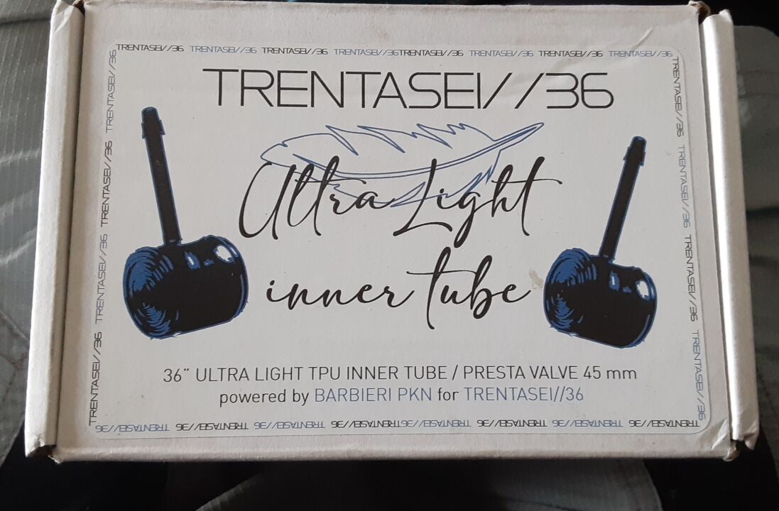

I have a 36er TPU but it’s closer to a 32er, as it must be stretched to get in on the rim! This causes much difficulty mainly because the tube gets caught under the tire bead and is almost impossible to push it in and out of the way. Then, if you get a leak, it takes up to 24 hours for the TPU repair patch cement to fully dry! I’ll stick with the Vee tire 36er tube.
There are indeed differences between TPU tubes. I think the manufacturers aren’t that precise. Most of mine tend to be too big; the 20" 24" Fatty, for example, tends to be too small. Either way, these tubes are generally more difficult to install than butyl. The advantage is simply their low weight, which is useful not only on the bike but also in a touring backpack as a spare. In terms of weight, they’re certainly a good alternative to tubeless, which isn’t easy to handle either.
I do carry one in my backpack on the off-chance my Vee 36er tube suffers a blowout such as a stem failure or other non-repairable leak. The Vee is dead easy to install onto my nimbus stealth ll rim, and has a noticeably larger diameter than my TPU, making the fitment so easy that tire levers are barely required. This is the 36er TPU that I have:
