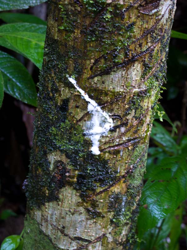

Funny, I just learned the other day about natural rubber being white. At least when it comes out of the tree that is… (taken in Costa Rica, near the Arenal volcano on Nov. 26.
