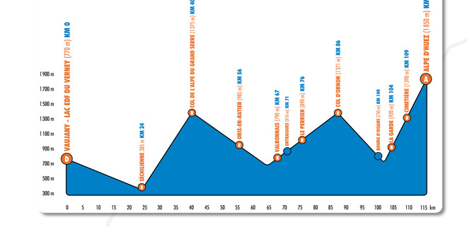

Hello, it is true that my English is very bad, I will make good crossed in 2010 of the Alps to France and I need councils for succeeding well, a too large wheel is not used to me so for nothing in the rises collars it is too stiff and that I do not arrive there and a too small wheel to do lot of mileage it is very difficult to make 120 kilometers per day, thank you for your assistance.

Hello, I am in France, I make triathlon since step badly of year, in 2009 I made an exit of 115 kilometers in the Alps, here is, my wish it is right to know if somebody has one or of the easy ways to still better roll in mountain on the road.
