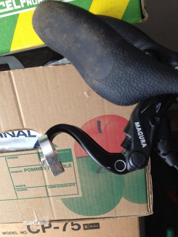

my magura brake lever got twisted … I do not know when and why!
what to do now?
You could bend it back (makes it more brittle for the next time)
Or you could lop off the tip and put the starfighter dohickey farther up the lever. Come to think of it you could bend it back and if it does break off, just do that. I would definitely try to figure out something other than replacing the lever. Maguras aren’t cheap! O_O
