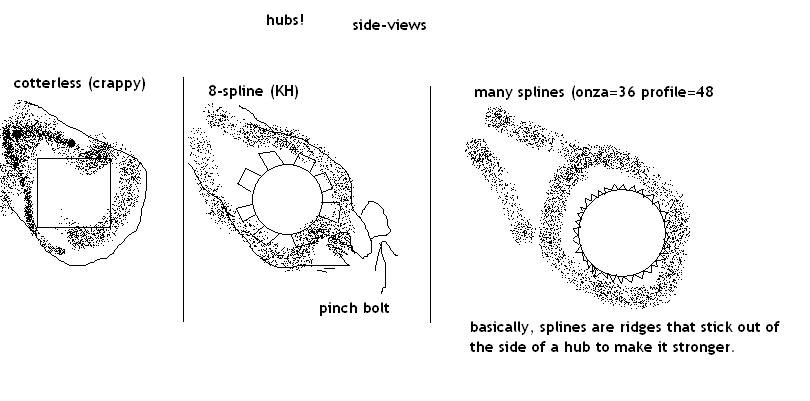

what are splines, you ask?
edit: well, John beat me too it while i was making that picture. oh well. he’s more correct than i am, but i got the concept down o.k. no humor this time, though.
