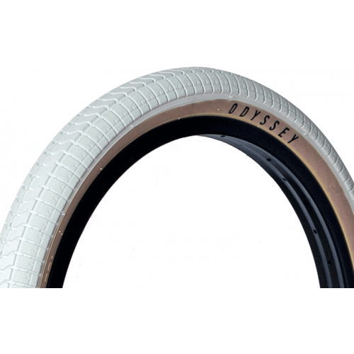

I’m using Odyssey “The Path” in white / (natural) tan.
It’s not discount quality, but not that much bigger; it’s 2.1
