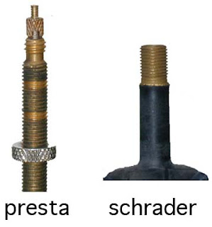

Most unicycles inner tubes have Schrader valve stems like the ones on cars. Bicycle pumps can usually be switched to use on either Presta or Schrader stems. Could it be that your mini pump is set for Presta right now? That’s all I can think of.
Hi Eddie. It’s the second type, Schrader valve. I couldn’t push the pump handle in a full movement. Seems like it needs some kind of harder pressure. Or there could be a hole in the tyre. I’m not sure. Is there any way to check that?

Can you push the pin in the valve by hand?
No I don’t think so, not by hand. I tried to release some air using a piece of metal that comes with the mini pump, and seems like the air come out just fine
Then the valve shall be fine. Either the pump does not have enough pressure to push the pin in, or it blocks the valve (however this can be possible), or the valve blocks something inside the pump (valve too deep or not deep enough in the pump?).
As I was trying to inflate my 27.5x3" tube with a mini hand pump, I had to plug on and off the pump at least 10x before I was able to get some air in. This pump only worked when its valve hole pointed vertical up and the valve was pushed in exactly deep enough and not a single mm too deep. Maybe your pump has the same problem.
