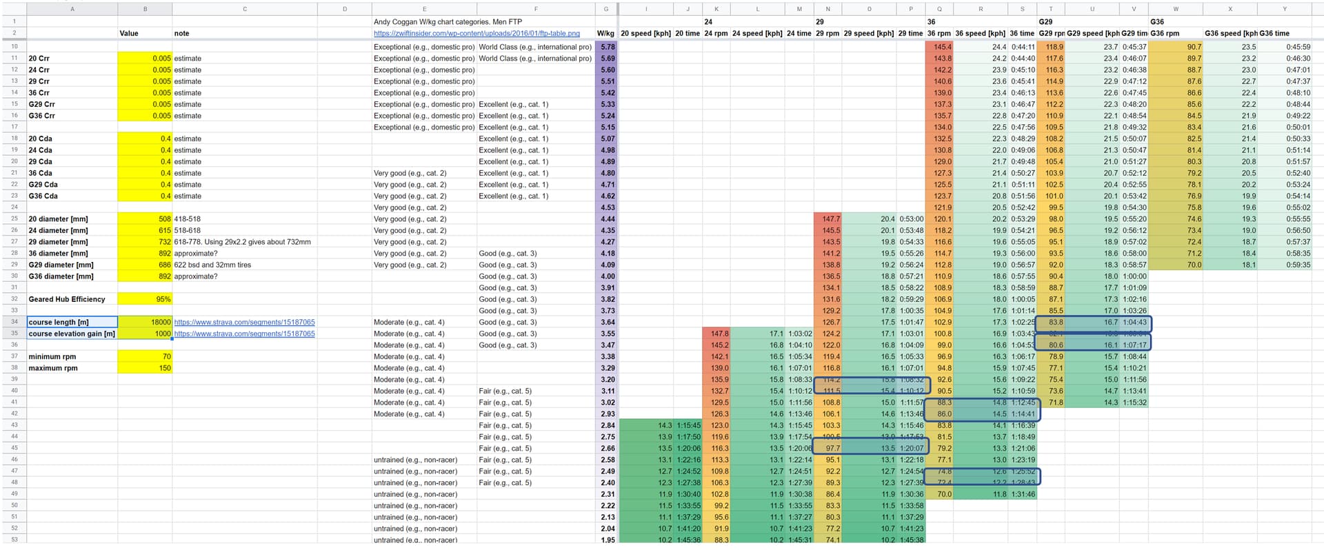

Some Mt. Diablo times highlighted in blue boxes in this picture. I just took the top few times I know of.
The fastest times are around 3-3.7 W/kg
The chart a few posts up in the thread, 3.7W/kg is 118rpm on 29, and 96rpm for 36 for the Unicon climb.
I think it will be a pretty close toss up between 29 vs 36 vs Geared at Unicon, all the way up to 4W/kg.
