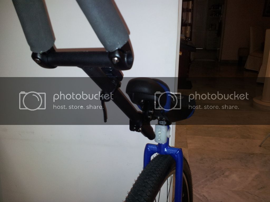

I’m trying to fix up the Tbar, and have spent a few hours trying to get the reinforcement plate on. It seems that the plate holes are impossible to align properly.

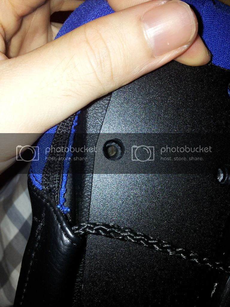

I stripped a little bit of a screw hole in the saddle base trying to fix it up. Thankfully, it still works.
I’ve noticed that pictures on the KH website show chrome bolts being used. My bolts are black. Are there different year versions of the plate?

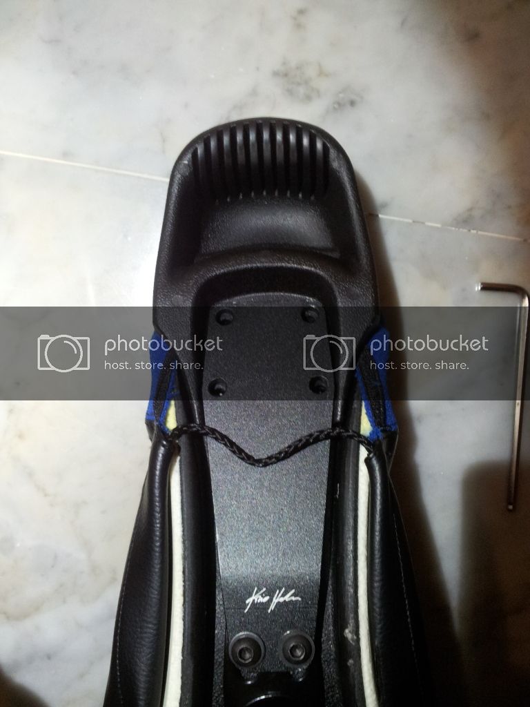

I don’t have a seatpost in these pictures, because it’s hard to take a picture with one. The saddle is a 2011 KH street.

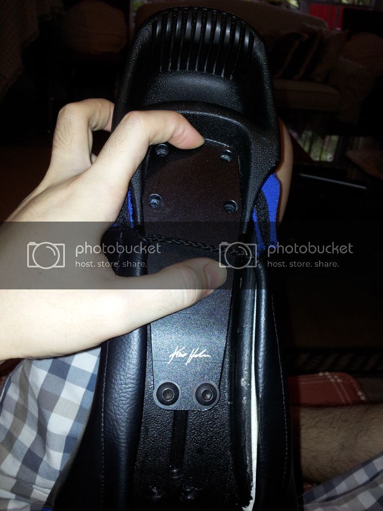

Here are some pictures.
The screws you see are inserted as little as possible, and the plate as far away from the seatbase as possible. When the plate is flush, the misalignment is worse.

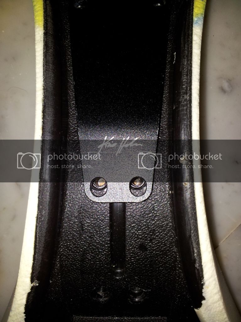

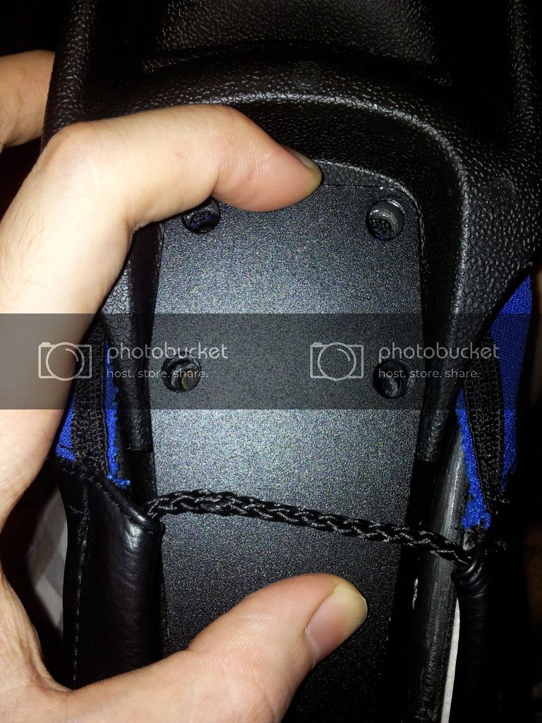

More pictures:
With bottom two bolts inserted.
With top 4 bolts inserted.
Picture shot right over the bolts, to avoid parallax error. I tried pushing the plate towards the front of the saddle, but this is the most it would go.
It looks like I may have to elongate the bottom two holes in the KH plate.

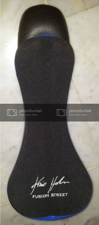

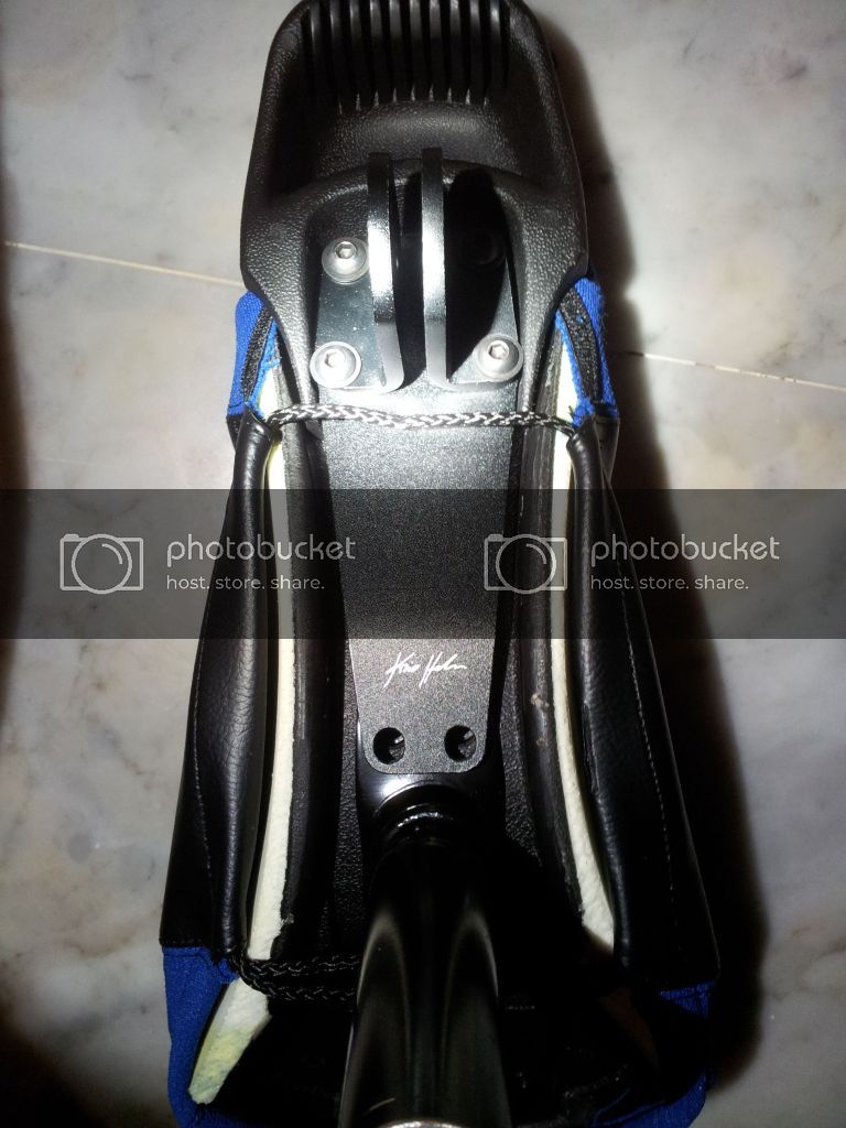

Here are some pictures of the seat itself.
I thought it was only the new style bases that used allen bolts into captive nuts (like the OP’s saddle), rather than the fixed bolts with nuts on the outside.

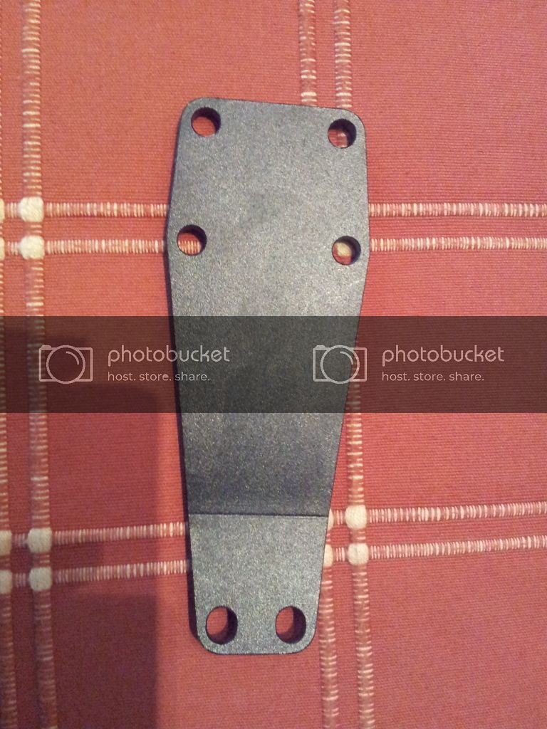

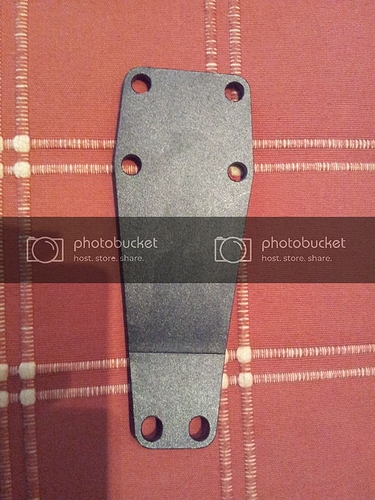

Here’s a picture with an allen key inserted. It fits just right into the screw hole.

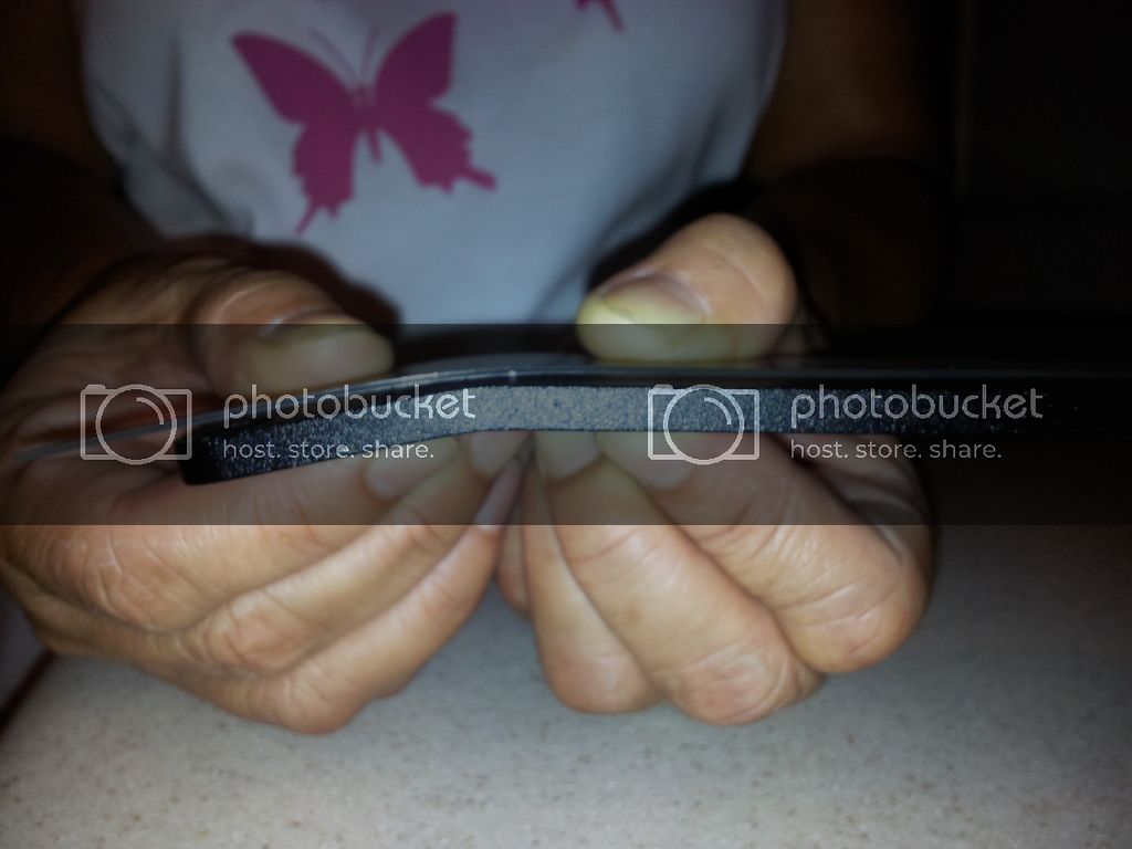

More measurements of the plate. Seems to be 128mm.
Had to get someone else to help me hold it.
Ruler follows the bend.
