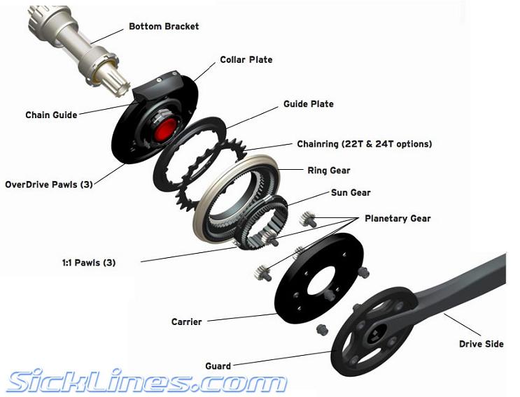

Maybe in the future someone could convince this company to build a geared hub for unicycles? Not that the Schlumpf hubs are bad (they are awesome!), but it’s always better to have an alternative. What do you think?
That’s pretty cool. Cable actuated (I assume), and can probably be adapted to any giraffe unicycle you may already have. :slight_smile:
Modifying it to be a hub drive rather than a chanring replacement might be some pretty major surgery though, which brings us back to the idea of a chain for gearing up the unicycle. This one, however, would allow you to shift on the fly, and not have to switch out parts, or flip the wheel around.
If the chainring was direct drive to the hub body and there was a spindle within a spindle which was attached to the crank, wouldn’t that work ?
and the Hammerschmidt is ISIS
The problem is that it is designed to give output to the back and the side that is facing our hub is stationary and takes control cable.
It would be interesting to combine it with huni-rex like construction, but the price is not test encouraging :wink:
It mightn’t work on a uni, but it sure would be awsome on a SS MTB.

Having another company would be good and slightly diferent gearing (1:1.6 instead of 1.5). Might b better if u could condense the gears into the hub like Shlumpf, assuming it can be made fixed and still shiftable.
My point exactly. I didn’t literally mean ‘too flimsy’, I meant ‘too flimsy unless beefed up to a stupid degree’.
Another thing I’ve thought of is the fact that the Hammerschmidt has a freewheel in it. One of the reasons why the Schlumpf is so expensive and chunky is due to the fact that it doesn’t freewheel.

You didn’t have the luxury of viewing the figures before you replied. The hub is clearly pawl released and free-wheels. It must first be made non-free-wheeling to be used on even a chain-driven uni.
Ben was right on with his original post. The manufacturer would have to be convinced to design a hub for a unicycle. This one won’t do. It does appear that the shift cable comes out on top of the chain guide which is advantageous to one that comes out of the axle. If the shift cable position could be maintained in a redesign, the cable could come straight up one of the frame legs.
