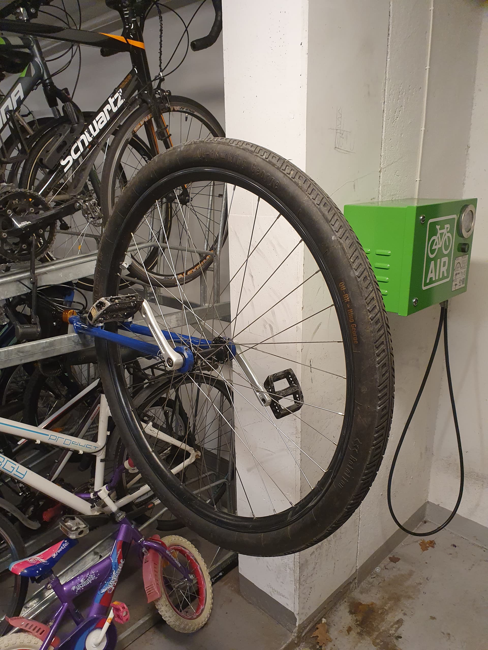

You probably do, if you use a bit of imagination. I use my frame as a truing stand, and just wedge it somewhere conveniently:
Truing your 36er is a useful skill to have. It is probably less hassle than shipping your unicycle back to the vendor anyways. I need to true mine regularily. I dont even take my tire off, but hold a pencil or something next to the frame with the tip close to the rim. And use a ruler across the frame above the tire to see if it is somewhat centered. Then I use a spoke key and a guide from a google search to true it.
The result isn’t perfect, but it doesn’t need to be either.

Are you sure the wheel is not true radially? On a 36er a wheel can be true and the tire can be mounted so that the tread does not run true. Check the line around the tire where the tire meets the rim. If it is off you can release the air in the tire and work the tire so it runs true.
