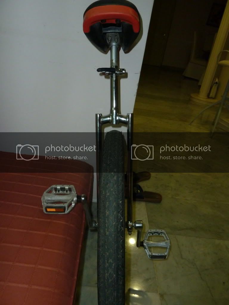

I’m attempting to learn how to unicycle, and got myself a used uni. Paid (converted to USD) around 100 bucks for it. 24"!
I read loads of threads here and some people have suggested that 20" is more suitable for learning, but I want to be able to go about the neighborhood or atttempt Muni in the future. I am only 5’3". I’ve had only 2 hours attempting to ride. I took half an hour before I could move a meter while holding to a rail. Now I can go up and down a railing with some difficulty.
I mountain bike as well, glad to have shin/knee guards and a helmet. It’s hard as hell, but I’m going to keep trying!
It looks like a Qu-ax, but I have no idea.
Also, there is a strange sound coming from the uni when it bounces. I have asked the owner about it and he is not sure where it’s coming from.
The unicycle is a cheap knockoff. The rim is decent, the seat sucks. With a square taper hub it’s not really suitable for MUni.
The noise is probably one of the bearing holders being loose. Tighten them to be a little bit more than hand-tight, but not so tight that the wheel won’t spin freely.

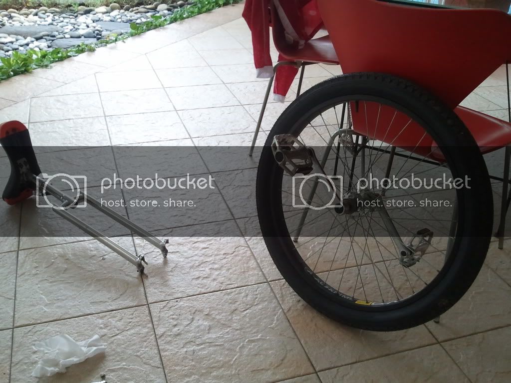

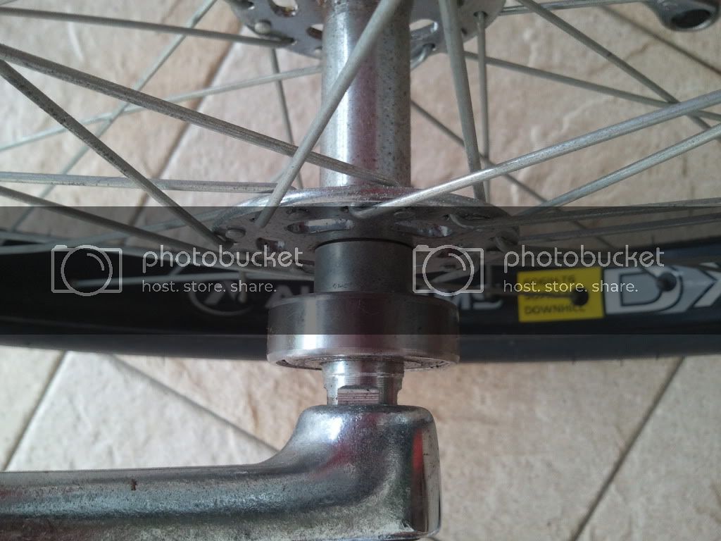

Thanks for the advice guys. I found the source of the noise. No idea what to do about it though, so just fixed it back together.
Hey, it’s just a spacer between the hub and the bearing, i am not sure how difficult they are to move, but you could slide you bearing so that its touching, which would have been how it was from new. But if the noise doesn’t bother you then i wouldn’t worry about. Hows the learning going?
