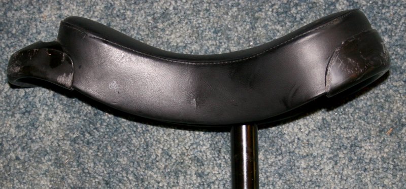

The insides of my thighs were getting chafed and bruised from learning
to ride on my Torker LX 24". I’m sure a lot has to do with the fact that
I am learning, but when I reshaped the seat, the problem went away
(probably partially because I’m riding better, but I know it is mainly
because the reshaped seat is so much better).
Here are pictures of the process.
Before Pics.

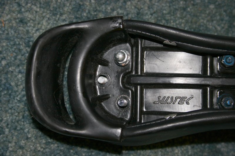

Remove the plastic bumper.
Open the metal clips with a screwdriver.
Untwist the wire and carefully pull off the front of the seat cover.

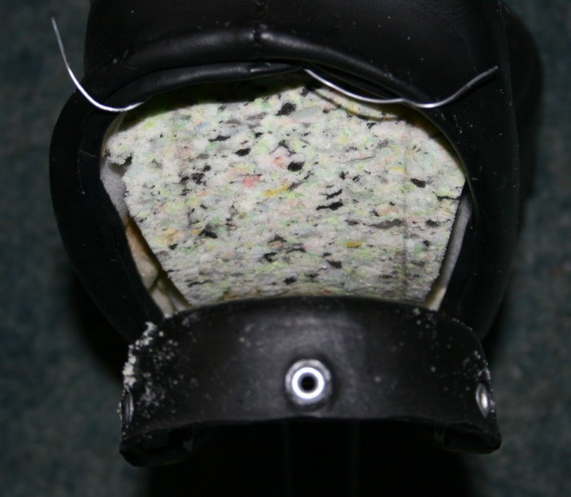

Peel back the front of the seat cover (keep thin foam layer w/ the cover)
Make progressive cuts working towards desired shape.
Easier to cut in small steaps than to put foam back.
Silicone can be used to glue errors back.
Tuck foam into seat cover.
