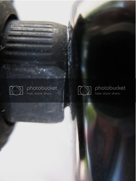

Arrrrgh, went on the parade today, and while riding along at slow speed on level ground, the right crank on the new unicycle did the same thing.
Here’s the old crank showing what happened to it. The pedal started wobbling as I rode, then popped out:
Here’s the crank on the new Torker LX, after it started wobbling. I bailed off before the pedal popped off, though.

It sounds like both had the wheel mounted backwards w/ the left crank on the right.
Lots of riding backwards can also cause this. I often carry a cressent wrench if I think I’ll be doing any backwards riding, and regularly check tightness of the pedals.
“It sounds like both had the wheel mounted backwards w/ the left crank on the right.”
Well, I can’t believe it, but you’re exactly right. I just went and checked. I know I looked at the “L” and “R” when I was putting it together specifically so I’d get it right. Maybe it was upside down when I did. I changed the tire on the old unicycle two or three weeks ago, and I must have gotten it swapped around then, as it’s been doing good for 7 months or so.
