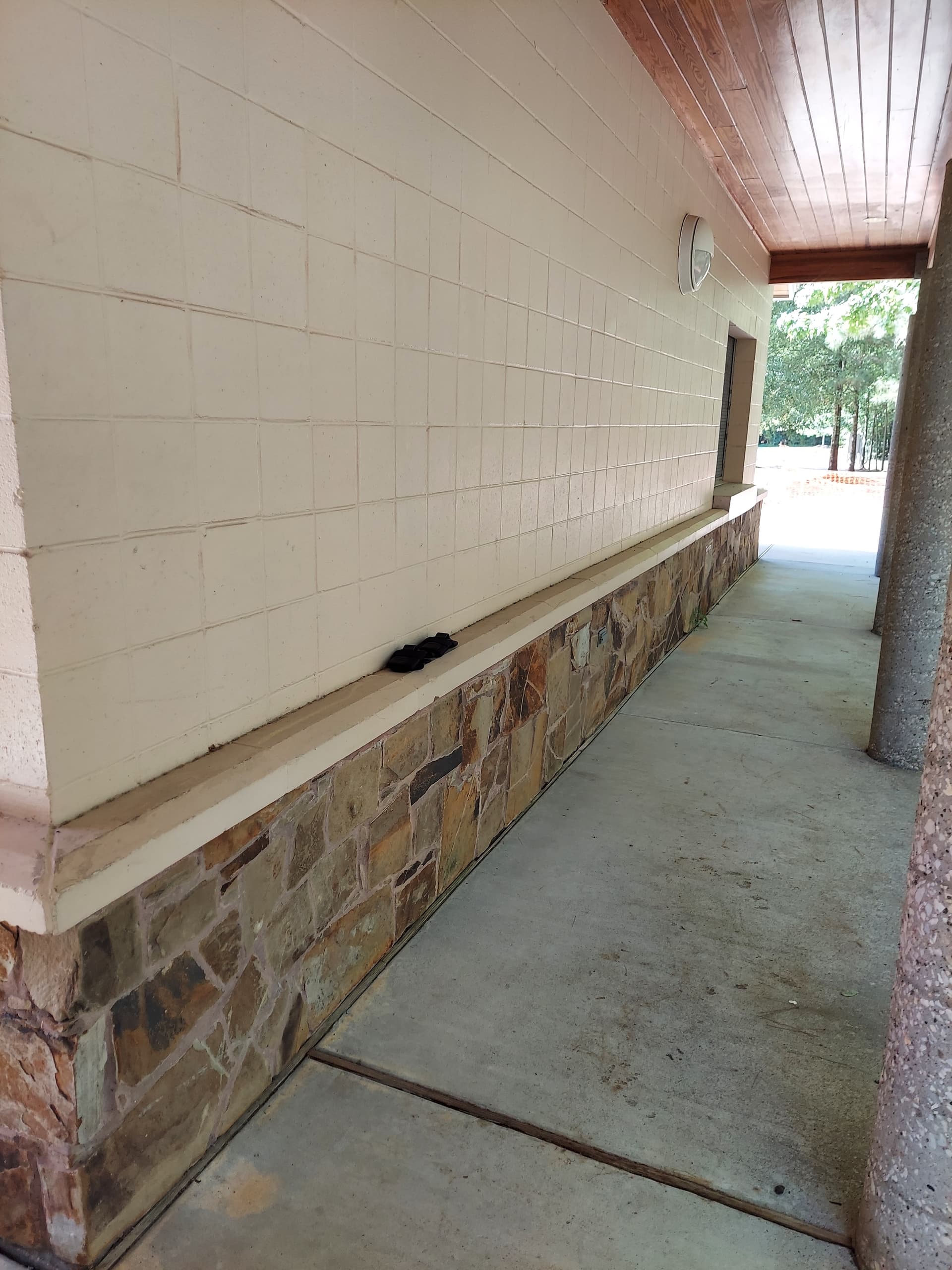

Today I have overcome my fear of falling off my unicycle, and I was able to ride the entire length of this wall.
