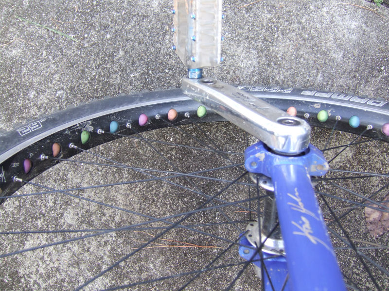

If you’re looking for rainbow things and you have a uni that has a drilled rim…
I used this to replace a blown rim strip on my KH29:
http://www.amazon.com/Wrights-117-798-002-Printed-Blanket-4-75-Yard/dp/B003W0UIE8/
Pretty neat effect, a different color appears in each rim hole and it works better than the original rim strip. I could probably dig and find a picture of my uni or even take one if you’re interested. Just tossing that over the fence.

Here’s a pic of my rim:
I see now that you don’t have a drilled rim. I wasted your time.
It’s 100% polyester, I slog through mud and deep water all the time and it doesn’t stain the colors.
That is a very cool look. And very creative to think of using blanket binding as a rim strip!
That’s nice looking!

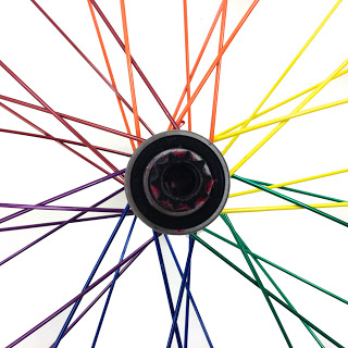

I’m vaguely interested to see these titanium rainbow spokes though. Not gonna use them, but I wanna see what all the fuss is about!
not mine but look at this: 1300g 24" rainbow
