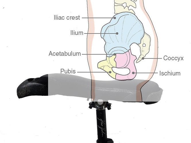

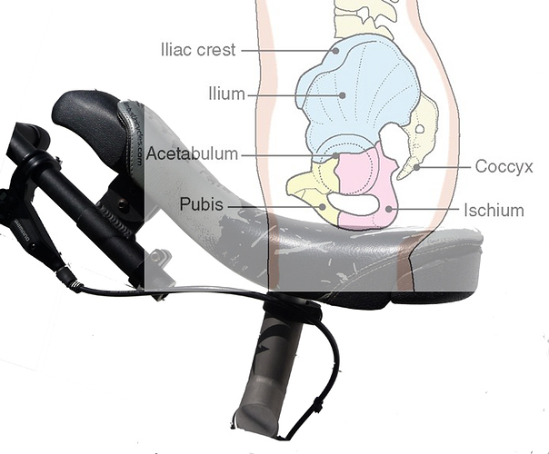

Here is a good illustration of why curved seats are uncomfortable.
I’ve photoshopped the images so that you would expect the ischial tuberosities to sit on the widest part of the saddle (the back). In reality, or at least my experience, you slide forward on a curved seat so you end up sitting on the lowest part of the curve.
This shows the bony structure of your pelvis. It is up to your imagination to visualise what happens to the male genitalia. It sits just under the pubis. I can’t speak for females, but it’s probably not as significant.
If I have time next week, I’ll get someone to do some Xrays of me sitting on the flat seat vs curved seat. I will irradiate my gonads in the name of unicycle science.

I’m not sure I follow your two images. In the second image it shows the rider’s body is parallel to the seatpost, and in the first it shows an angle between the rider’s body and the seatpost. Shouldn’t the angle here between the two setups be the same? Or does it not matter?
I think if you angled the front part of the seat higher in the first diagram, the rider could not move forward on the seat and there would not be the “compression of the jewels” as a result. They would be sitting on the flat back part of the seat.
