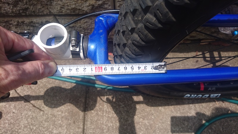

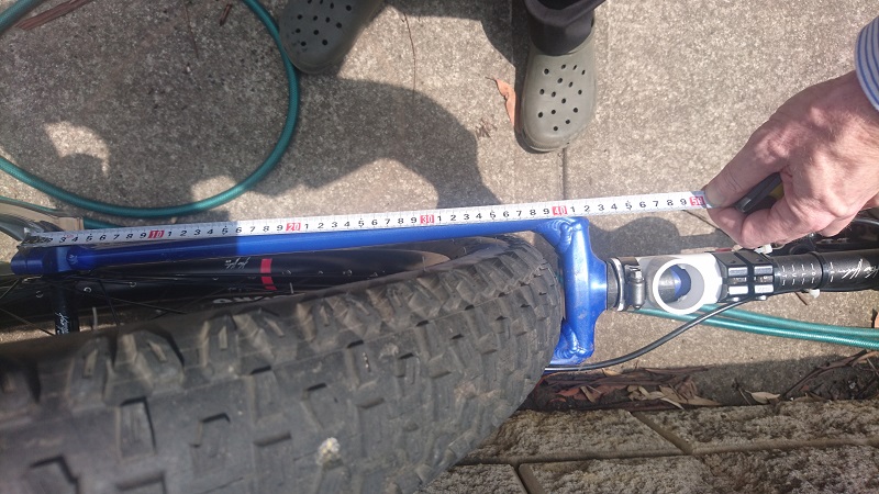

In reply to your PM:
Not quite sure what measurement you need, but here are some photos against a tape.
From top outer edge of rim:
From hub centre:
My KH29 was bought in Oct 2018 and I think it’s the current shape. Disc mounts only.
Let me know if you need other photos or exactly where to measure.
That’s great thanks for doing so!
I’ll compare with mine this weekend.
