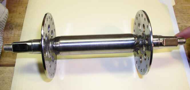

Hunter is making the frames to fit whatever hub the person has. He has made one wide hub version, a Semcycle hub version, and I’m sure he’s made one that fits the Suzue or standard Coker hub.
Nathan’s frame fits a custom made wide hub that is about 120mm between the bearings. It was made by cutting a Suzue hub in half, putting a sleeve in between, and then welding the pieces back together. This work was done by Tom Miller at The Unicycle Factory.
The Semcycle hub is a little bit wider than the Suzue hub, but is not as wide as the custom made w-i-d-e hub that Nathan has. I also have a w-i-d-e hub, but I’ve been slower in getting the thing built up into a functional uni.
I’ll attach a picture of the custom made wide hub.

If you have a stock Coker it is easy to spread the frame legs to accommodate the wider hub. A bike shop can do that, ensuring alignment, or we can do it here for a small additional fee if you send us the frame. Otherwise, there are a couple of custom frame builders that can build to the better wheel, including Rick Hunter.
