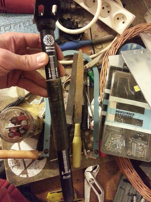

Hi, I have a little problem, I have 36er QuAx Unicycle and I use it for long distances with saddle high, but also for light offroad (similar paths as those on the beginning of this Coker vid https://vimeo.com/11815056 ) where I need to sit as low as possible but on 36er is that tube where the seat post is fitted very short, so now I have two seatposts with different lenghts, but change seatpost and saddle every different type of ride is pain, so I need telescopic seatpost, something like this one below but with 25,4 diameter and for unicycle saddle… :thinking: … sorr for my english :wink:
any suggestions?? :stuck_out_tongue:

Thks for your advices. Finally I made it by myself. After unsuccessful attempts to find 25,4 tube with 1mm wall thickness, the solution was already in my garage. My ancient beginner uni 20" from LIDL network(uni cost 20€) is whole from steel and it also has steel seatpost with diameter 25,4 and wall thick 1mm soo perfect match. I ordered 25,4 seatpost clamp and 22,2 seatpost …VOLIA:
here is album with bigger photos http://imgur.com/a/4LZWd
