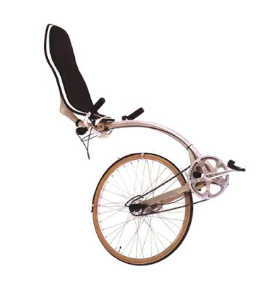

though intriguingly when I did my search on google to find that (which I remembered seeing on here) I also found this, which apart from being a recumbent appears to have a multi-speed hub, oh and clipless pedals and long cranks. It’s a photoshop job isn’t it? :frowning: :
Probably. If it isn’t, the drivetrain won’t work and I don’t recommend those pedals. :slight_smile: However, the designer may have solved the suspended seat problem. Looks like the distance between seat and pedals will remain relatively the same when bouncing around. And I think you would bounce a lot…
Those two made by Lobbybopster are uber-cool, to say the least. It looks like they should be in a science fiction movie.

That recombent-bicycle-looking picture looks unridable to me. (That said, I’m sure there’s someone who would do it, just to prove the point.)

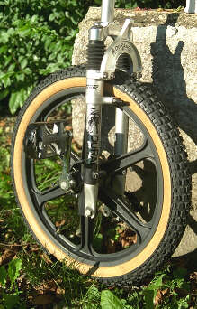

An other suspended muni test : Thierry bouché’s1997 prototype

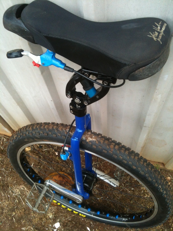

I dont know about just using the tyre for suspension, its nice having a extra 3" of travel ,especially when your a lazy rider like me,I like to sit down on trails.
Hey Jimbo, why are you running your frame backwards?
