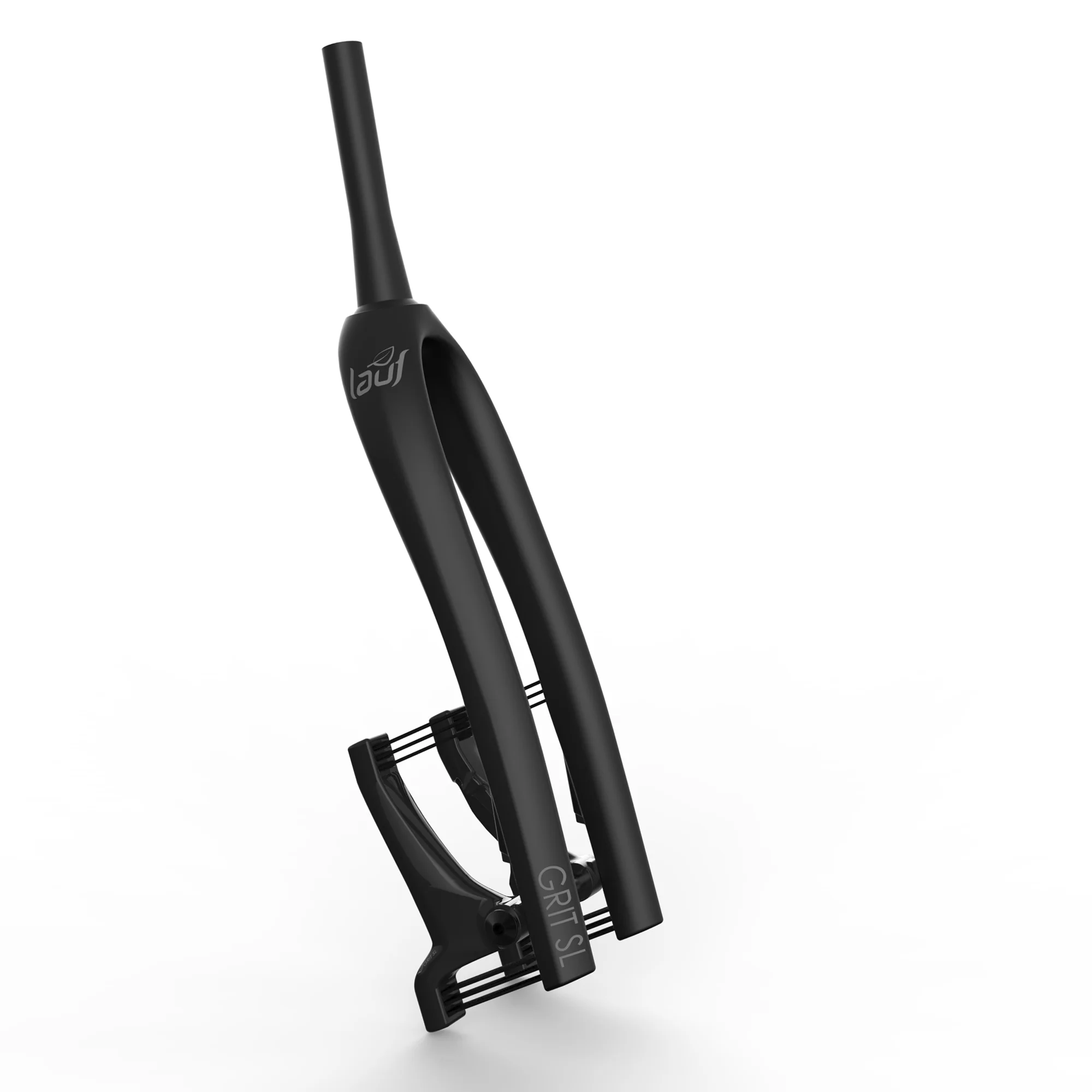

I don’t think that mountain bike shock absorbers are suitable for that, because they are pretty heavy and lead easily to great range of motion. But watching what is used in the gravel bikes world might be the solution. I am mostly thinking about composite springs, such as used on the lauf grit fork :
It would still be the legs that would provide most of the springness, but it would prevent getting a too sore butt after long times on bumpy roads / tracks (it might even prevent hard balls crushing in some specific cases).

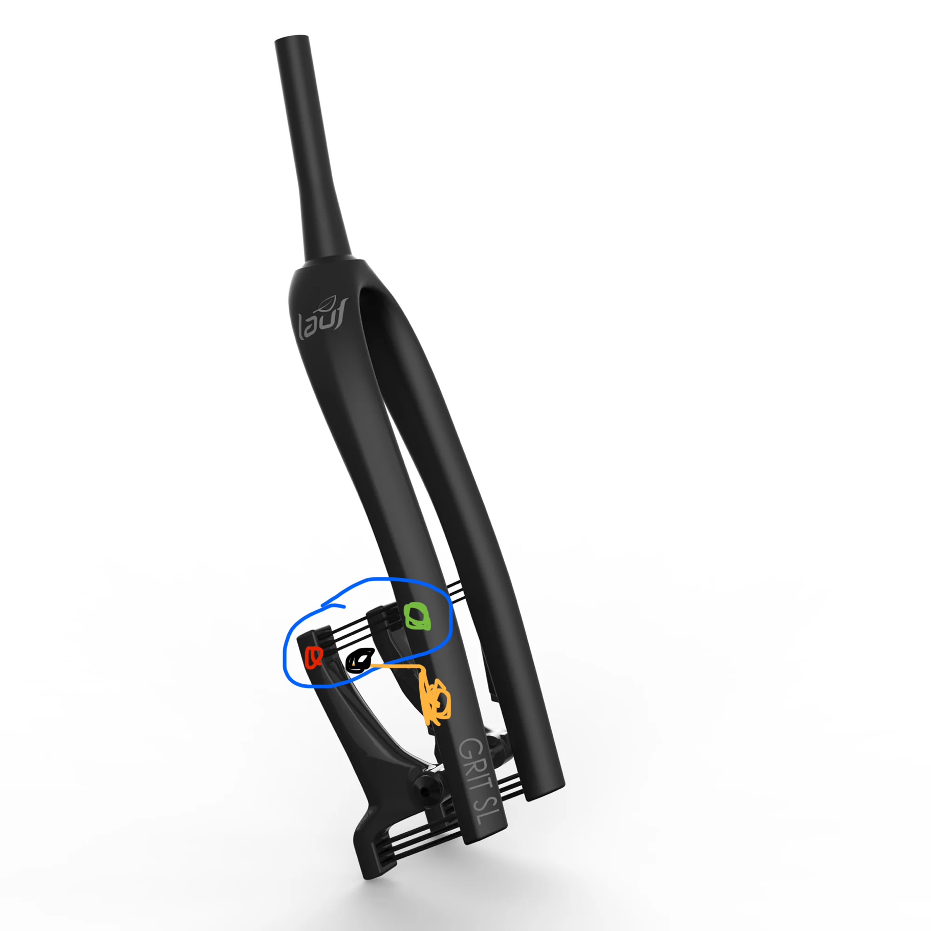

Something like this picture may be a very viable option though a slight change in the location of the wheel and a tensioner is needed. I’m not at home right now but I can give an example when I do
Ok a bit of a crude drawing but you can use a derailleur as a tensioner by threading the chain through only one idler and it will work both forwards and backwards. Key: Red=wheel, Green=pedal axle, Blue=chain, Orange=derailleur, Black=idler wheel

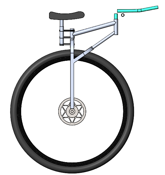

My idea is exactly the opposite. I think internally geared hubs are the way to go. My idea is to put the springs on the saddle tube. It is obviously more designed for road riding, but for light muni, it might work too.

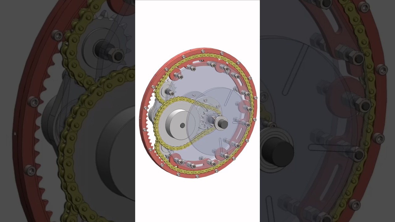

This would be big and bulky but a modification of this could work and I can make a basic model pretty quick on my break.
On if the modifications I would want to make is to replace the chain with something similar to a capstan drive with string to save about a pound of weight, or maybe a toothed belt
