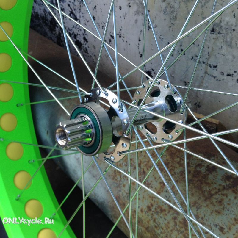

This russian website has a good range of rims (I think) for very affordable prices. Your only issue here is getting it shipped.
I have bought the 24" fat bike rim from them before
They also have 120 TPI Chaoyang 24" tyres which at the time were almost impossible to get anywhere.
