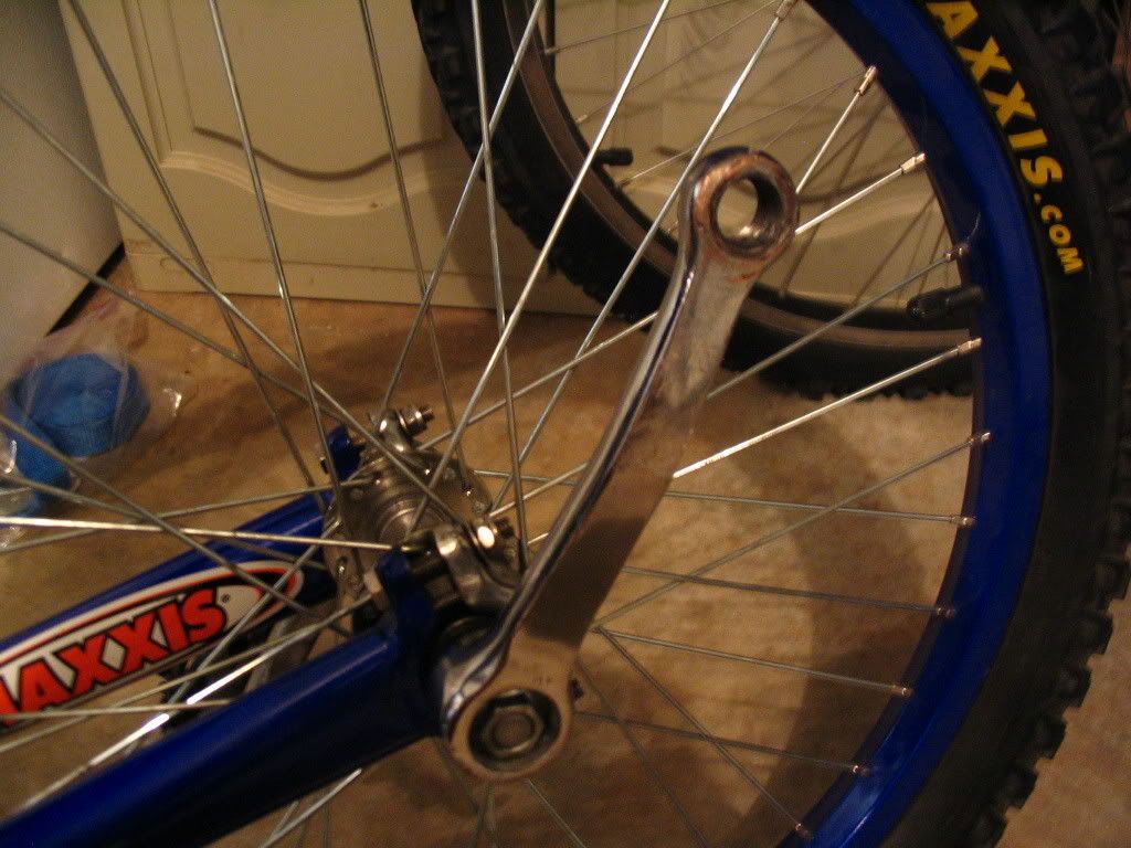

We seem to have stripped the threads where the pedal goes in, on our cheap learner unicycle. I was wondering if bike stores would carry square taper cotterless cranks or if I’m better of ordering of UDC. We are not ready to get a new unicycle, just to fix this darn crank :frowning:
Everyone loves pictures :slight_smile:

who cuz if you think of it just for a min I don’t think it will work and aren’t your crank’s all bent??
they look like it in the pic

eh kinda late in replying but u could always do what I did. drill a hole in the pedal and tap it then get some washers and bolt that sucker back on there. haha not very reliable but its a cheap fix.
Yeah this is a recurring problem for me, I…
-Got a bike-shop to re-thread it (all good so far)
-engineer to wield pedals on (ok but have snapped unless done both sides)
-buy ‘lock-tight’ (metal glue) as a preventative strategy
