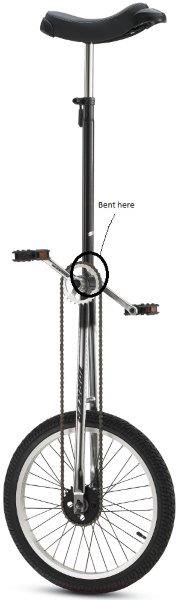

I’ve got a torker tx 5ft and the frame has been slowly bending. Has anyone had good luck straightening one? How would I go about it?
Would you post a picture of the twist? I might be able to offer advice if I can see the problem.
It’s dark know so I can’t post an actual picture, but I can later. It isn’t really a twist, it is bent forward at the sprocket weld. I think if I just grab and pull I should be able to straighten it but I’m hesitant to do so without input from others who have done similar.
It’s the weak point in most giraffe frames. Best solution is to find someone who can weld some gussets in there (front and back). After bending it straight first, though if it’s a little bent and then reinforced, the bend won’t matter.

Need a picture of the real damage. I can wait.
I think the frame designer didn’t consider that the riders of these do rolling, as well as static, mounts. The rolling mounts put a tremendous amount of stress on the frame. You might want to switch the seat around and mount the other way around a few times. That might bend it back straight again. After that, have a gusset welded in, or learn to climb it standing still.

Probably taboo, but if it was my giraffe, I’d lay it down with the bend facing up, and stand on the bend. Works everytime, it’s easy, and quick. I’ve done it a ton on my giraffe seeing as how it bends if I look at it the wrong way.
That’s what I was originally tending to do, and still might. I just hope that it doesn’t happen too often.
If you do running mounts get used to a bent frame…
And it bends if you look at it the wrong way because it’s been bent and unbent so many times. That’s why I recommend the gussets as the easiest/cheapest long-term fix. Or get a different giraffe with a stronger frame, but that tends to be the weakest point on most giraffe frames that bend. Running mounts also put side force on; I was fortunate to only bend the seat post on my old Schwinn Giraffe while I was learning to do a running mount one-footed. Fortunately those were strong frames, and did not bend as easily.
