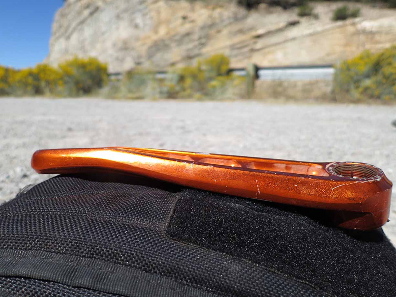

I have so far been unable to find compatible cranks in anything other than 6061, which is just far too weak.
Don’t blame the material, blame the design - 6061 should be strong enough given a decent design - those cranks look like they have a lot of material removed and poor torsional stiffness/strength.
