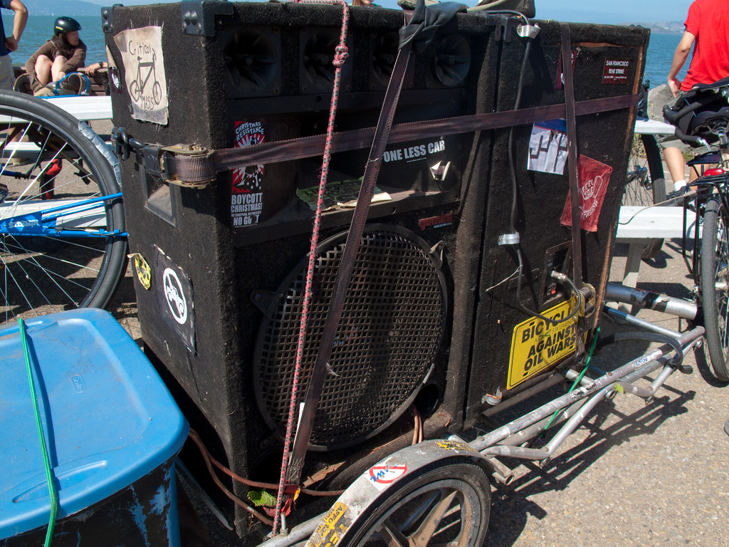

For a “Cadillac” system you need something like this:
That’s what the Berkeley Critical Mass group uses for their monthly traffic-slowing ride. They are nice enough to loan it out annually for the Berkeley Juggling/Unicycling Festival. It lives on a bike trailer. The battery (and amp, I presume, live in that plastic bin, to keep them dry in bad weather. Then it’s all run by an iPod, which normally lives up on the handlebar of the bike doing the towing.
Those simpler, more affordable Bluetooth speakers Moron described should be good for an intimate outdoor event, such as a small crowd without a lot of background noise. But for a parade you’ll need a lot more oomph. Never underestimate the power of the outdoors to make your audio seem weak, especially when there are bagpipes or marching bands nearby!
